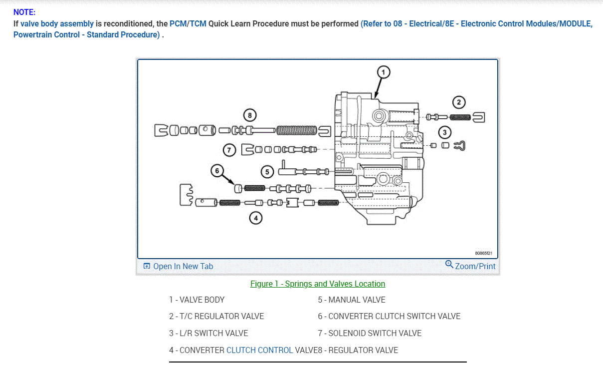

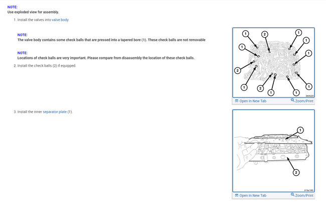

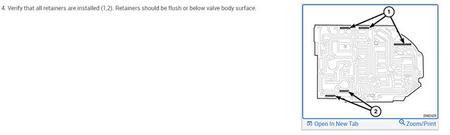

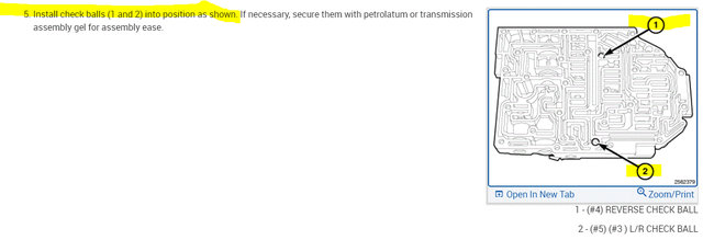

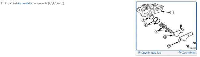

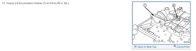

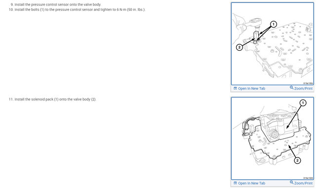

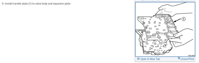

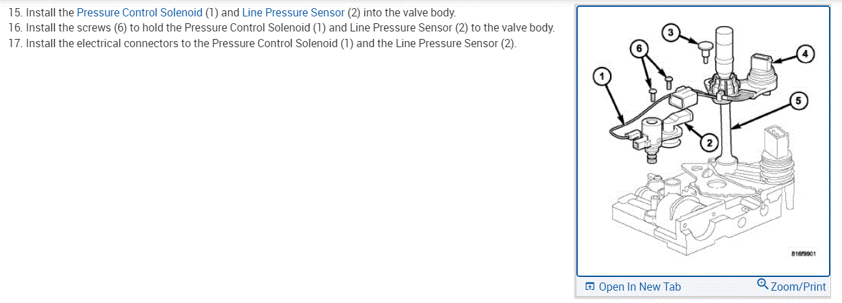

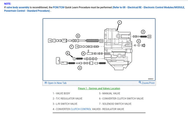

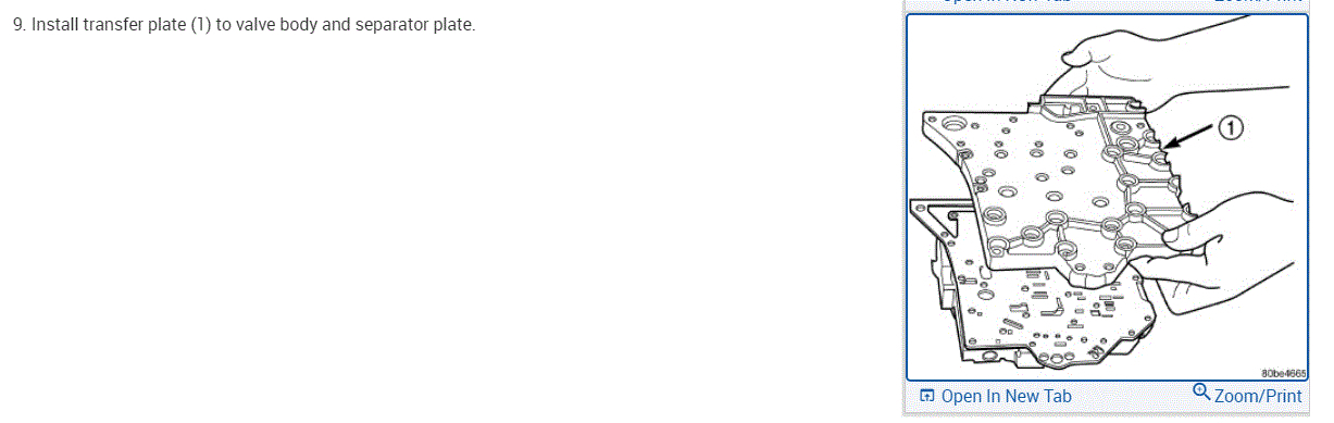

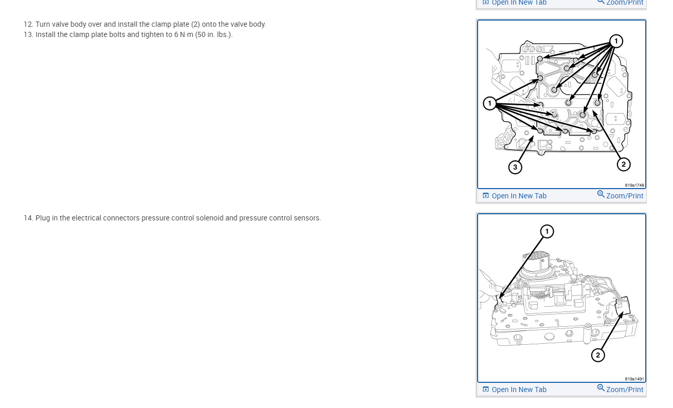

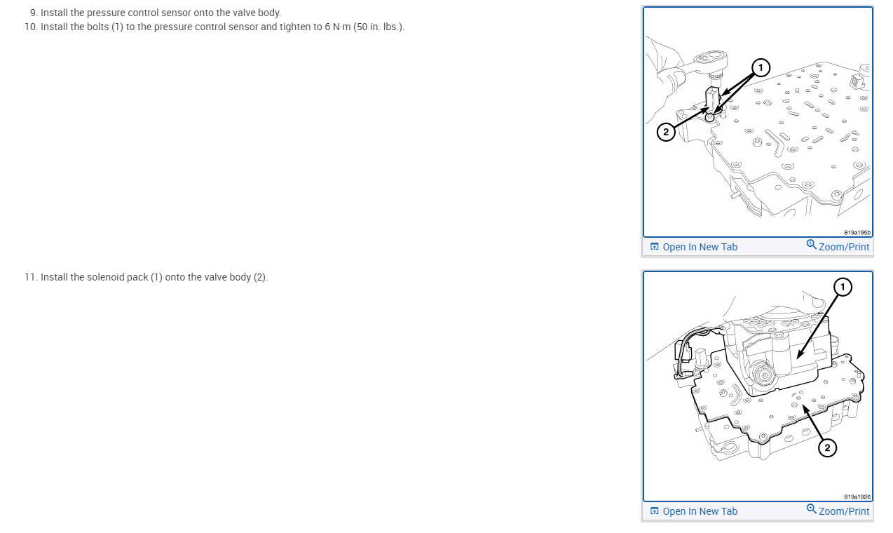

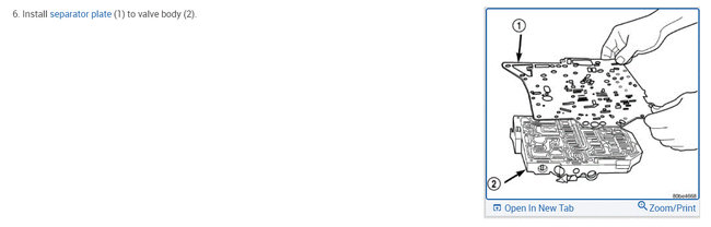

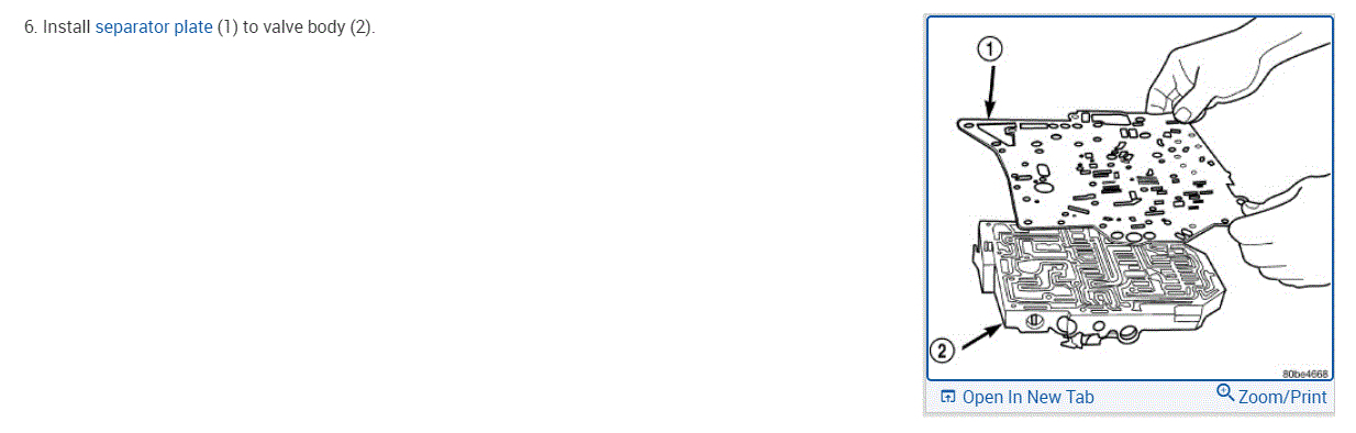

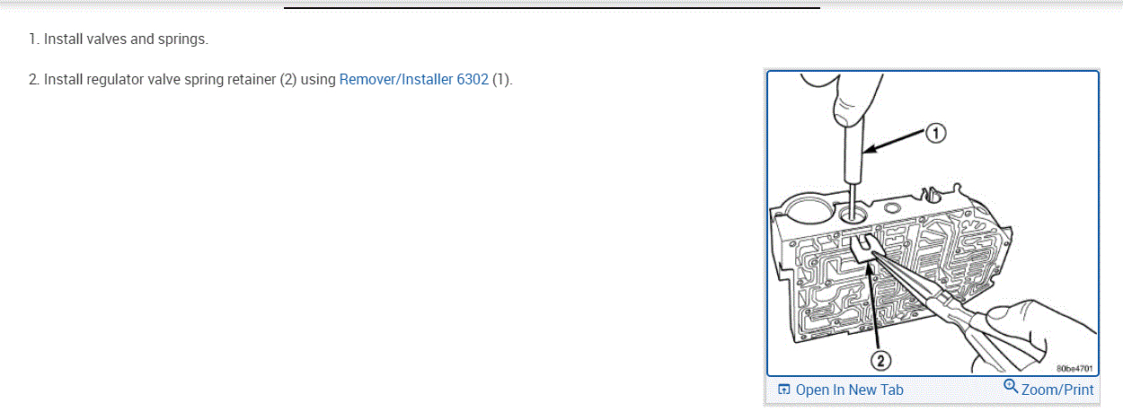

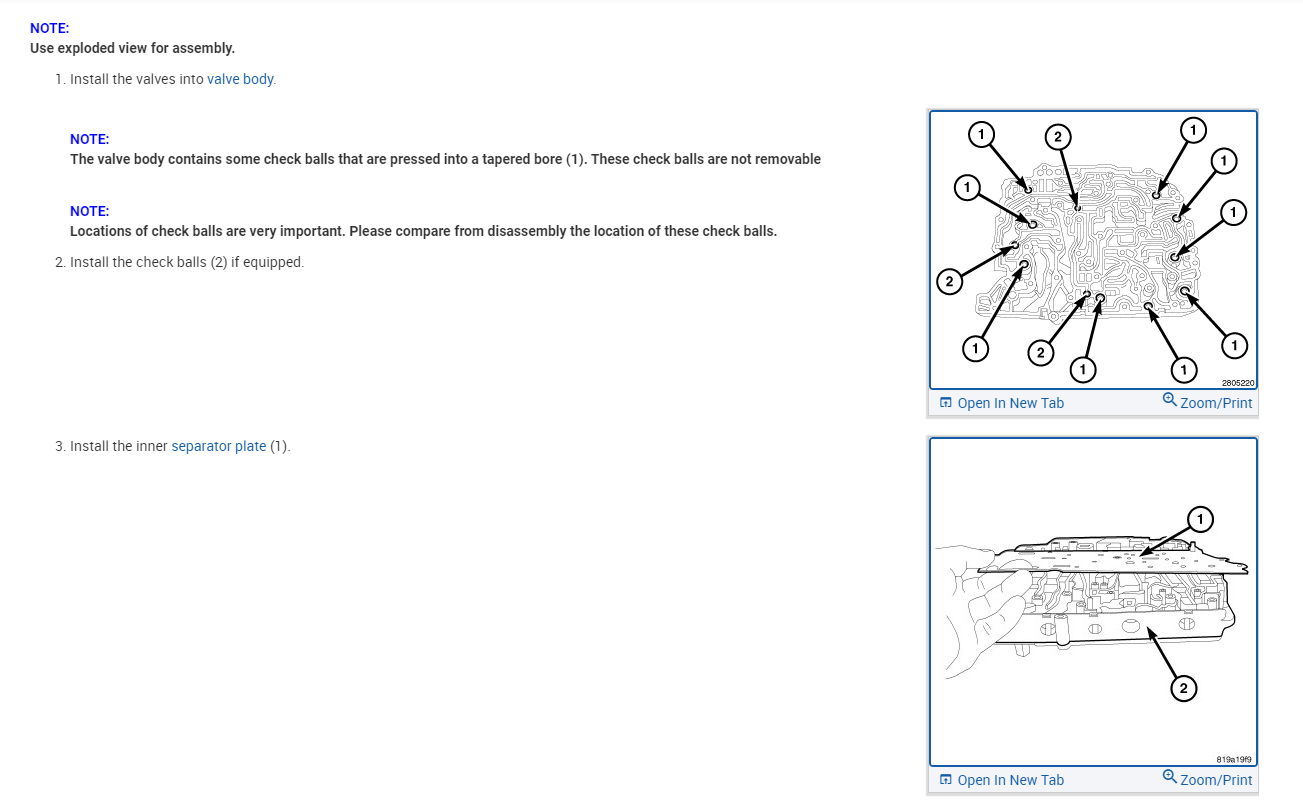

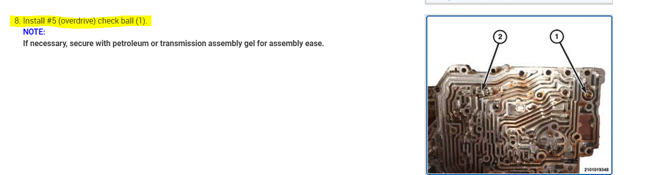

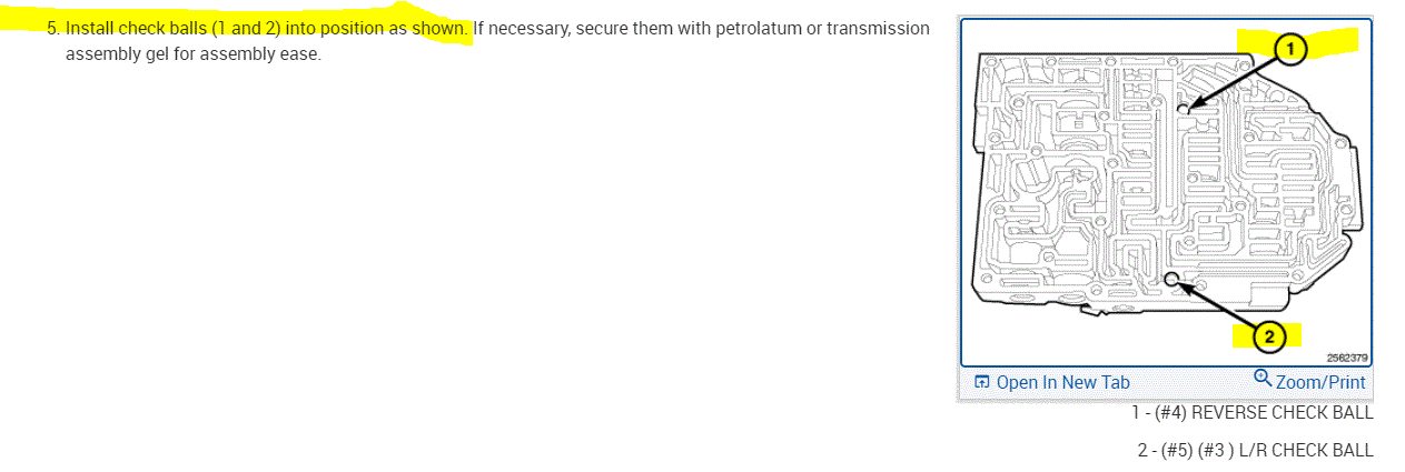

I'm putting together a valve body in the 4-speed automatic and need to know where the ball valves go? there are two of them.
Dec 13, 2021 at 6:49 AM
Good evening,
I attached the breakdown of the valve body showing the location of the check balls.
Let me know if you have any other questions.
Dec 13, 2021 at 9:05 AM
  • 110,240 POSTS

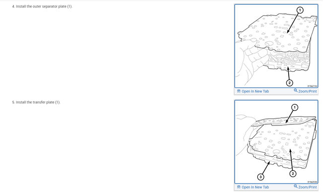

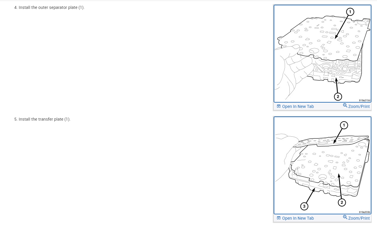

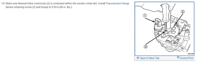

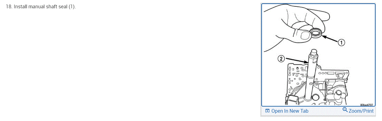

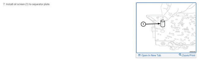

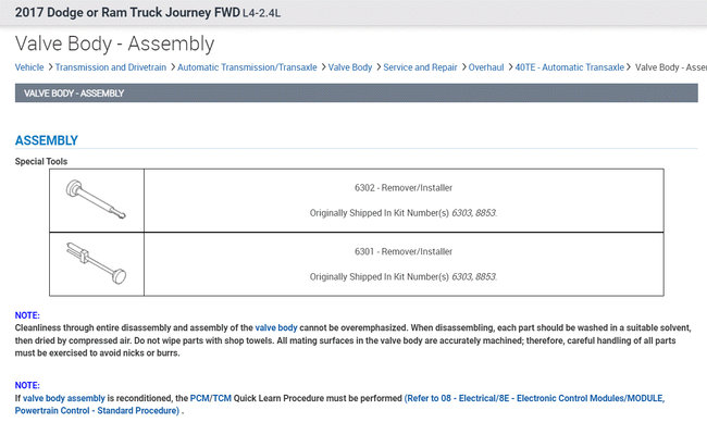

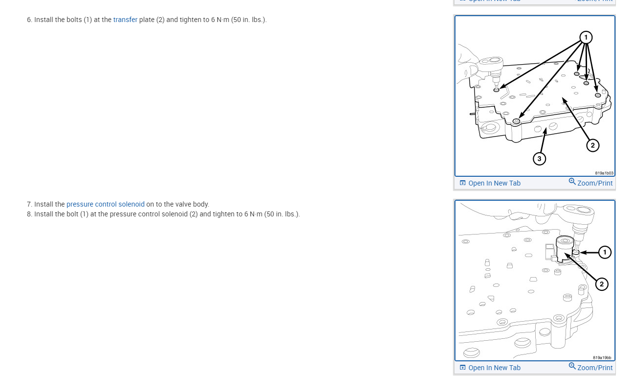

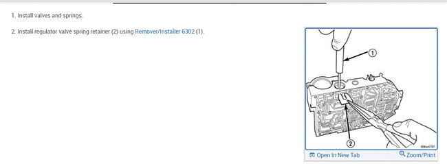

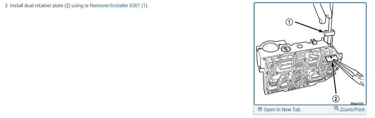

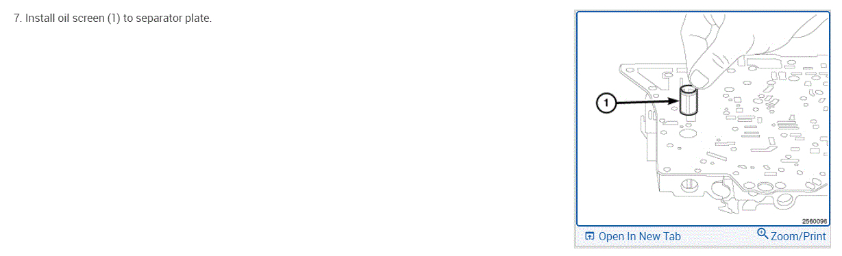

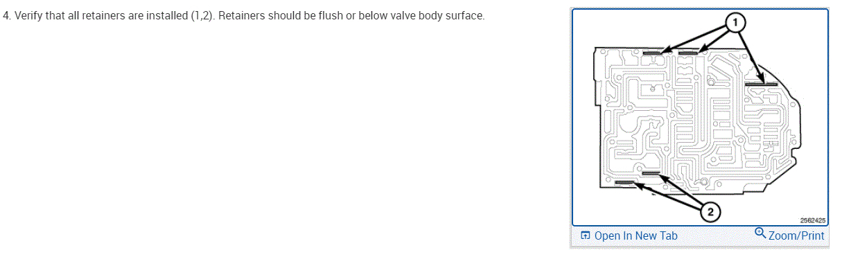

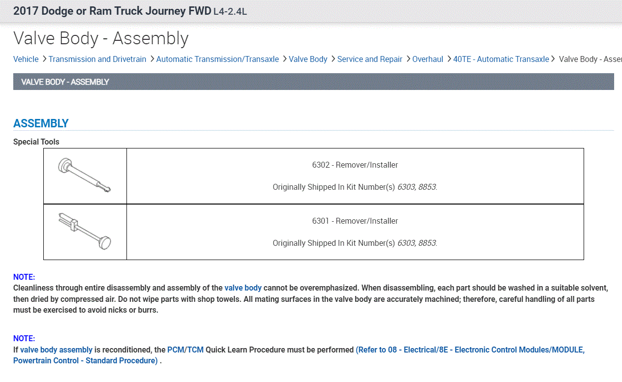

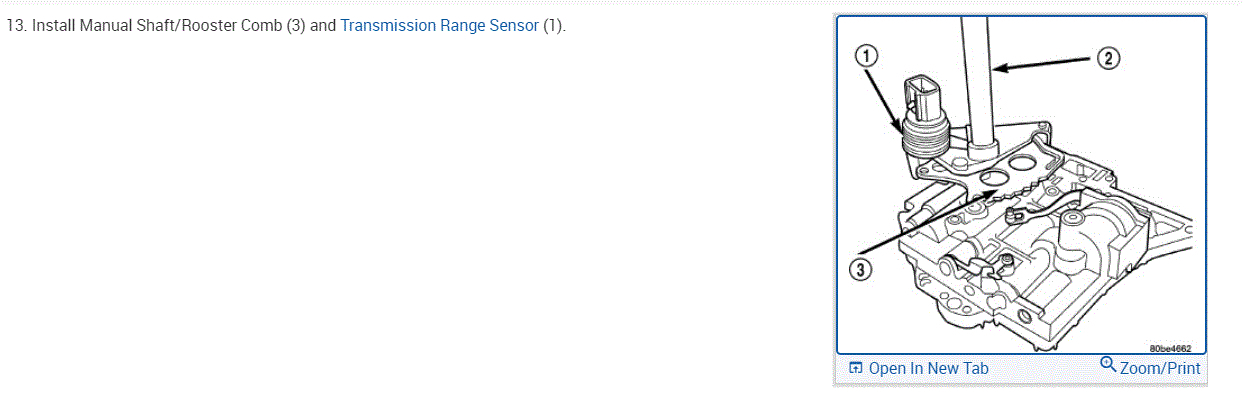

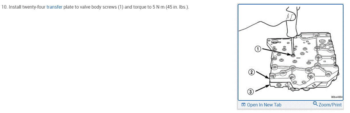

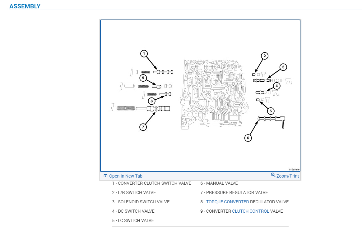

If it's the 4 speed, I believe it is 40TE transmission. If you look at the attachments below, they provide the reassembly instructions for the valve body. I included all steps.
Additionally, it also shows the two check balls locations. I highlighted the heading on each of the relevant pages.
I hope this helps. Let me know how things turn out for you or if you have other questions,
