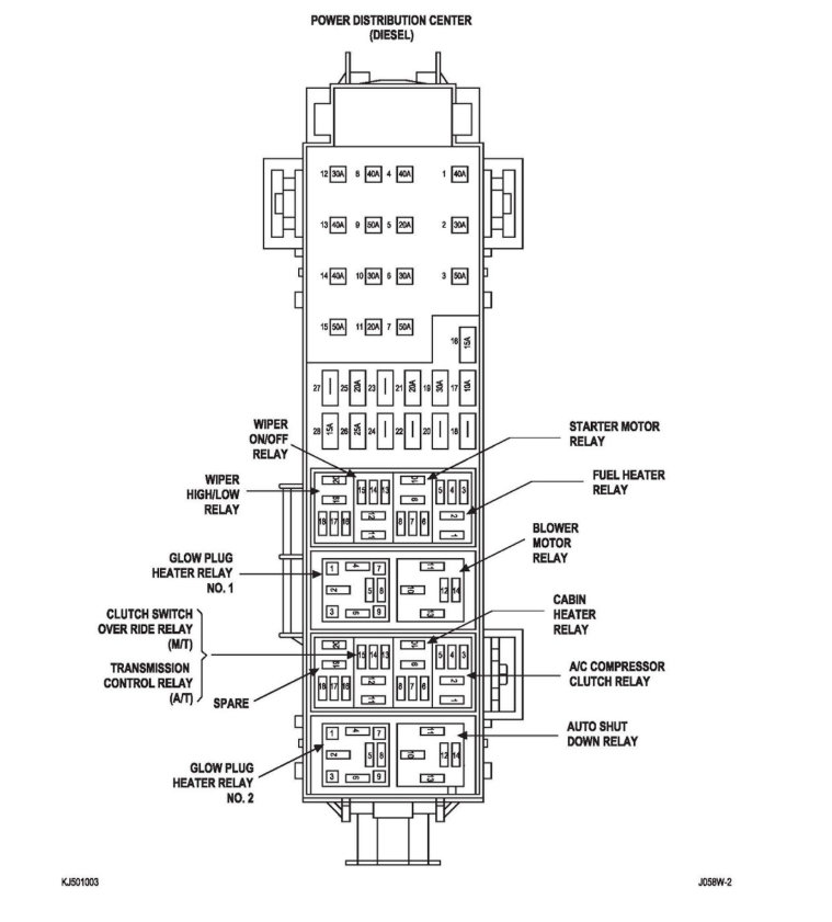

Hi, hope you're all doing well.
Today on my way to the shop, 2.5 miles away my vehicle was acting funny. I have no codes right now. These are a recent just of repairs I've done:
All new spark plugs.
New second cylinder ignition coil.
New crankshaft sensor.
So it felt like I was getting stuck in low gear. I read online it could possibly be a solenoid. What other possibilities? Thank you
Jan 14, 2020 at 12:54 AM
  • 55,808 POSTS
It sounds like the transmission control relay is going out. here is the location so you can check it out and a guide to help you as well:
