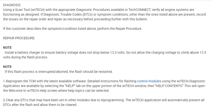

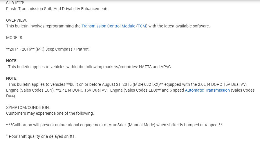

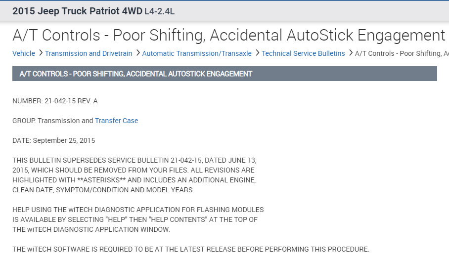

As far as the shift issue, my first suspect is the transmission control module (TCM) needs to be flashed/reprogrammed with the most up-to-date information. I was able to find a technical service bulletin specific to a delayed shift.
I attached the TSB below. Mention this to the shop and let me know what they say.
