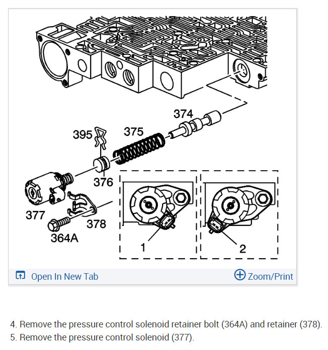

It sounds like the forward clutch pack is bad. When's the last time you serviced the transmission? The transmission should be serviced every third oil change.
Dec 13, 2023 at 10:33 AM
  • 55,721 POSTS

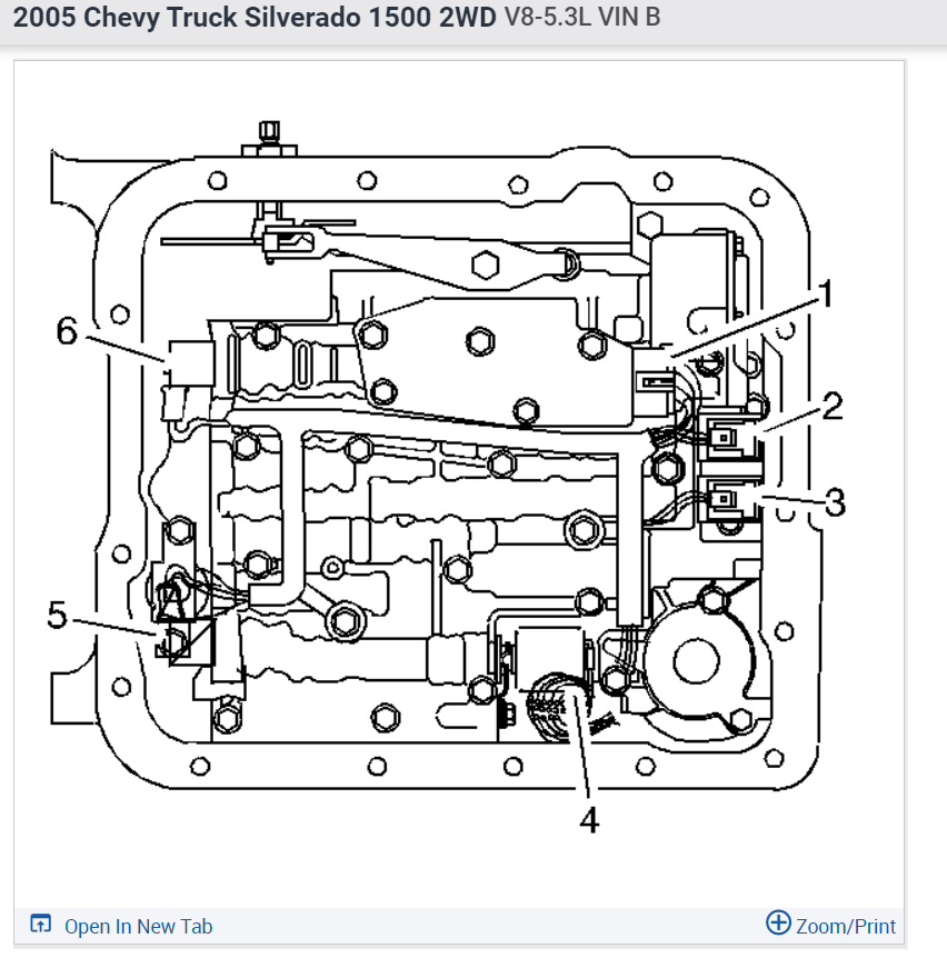

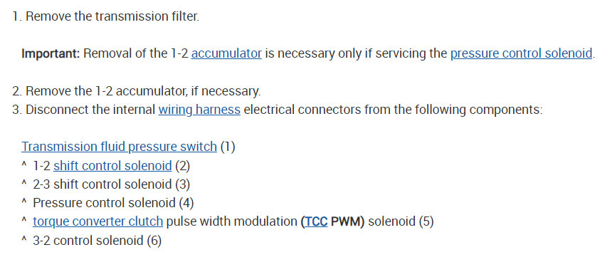

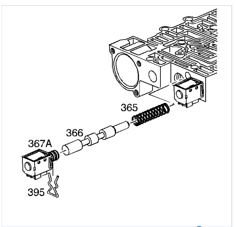

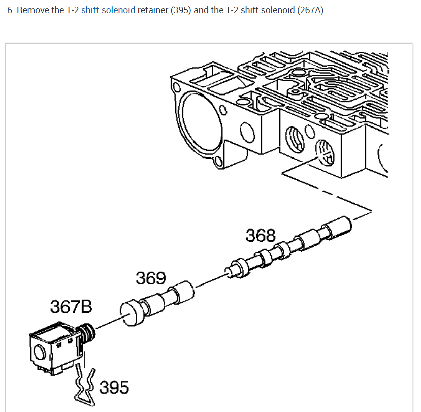

We should run the codes because it sounds like the first gear shift solenoid is not working, this guide can help, and I have included how to change the shift solenoid out in case a code is present for it.
This guide may help as well:
Check out the images (below). Please upload pictures or videos of the problem so we can see what's going on.
