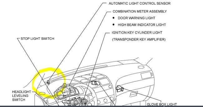

With selector at auto, the headlights do not come on at dusk.

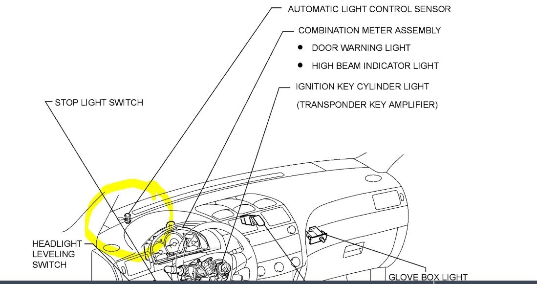

Good morning,
The light sensor does control the headlights when it gets dark.
I attached the location of the sensor for you. I would start there as the sensor is easy to access and not that expensive.
