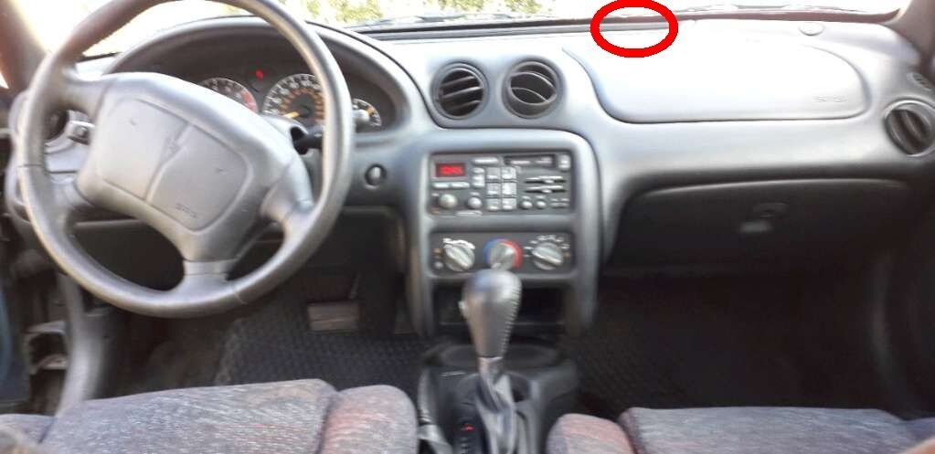

Are you sure the part fits my 1997 GA?
I looked it up and it shows to fit a GA from 1999 to 2005.
GM (10067986) I found suits the 1996 to 1998 and this one is nowhere to find.

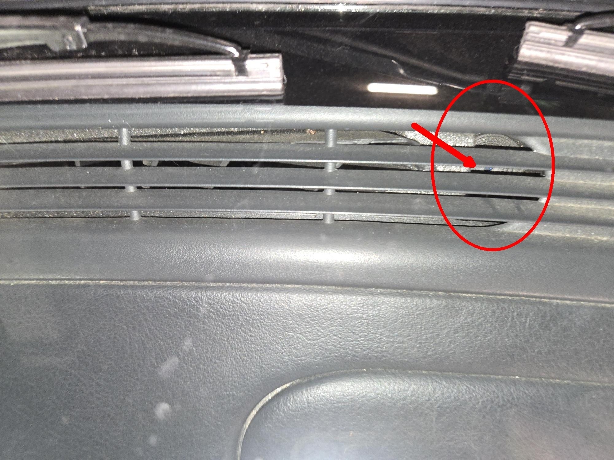

Please have a look at my Dash (picture attached). The sensor is not visible.
Do I need to remove the grille close to the windshield?

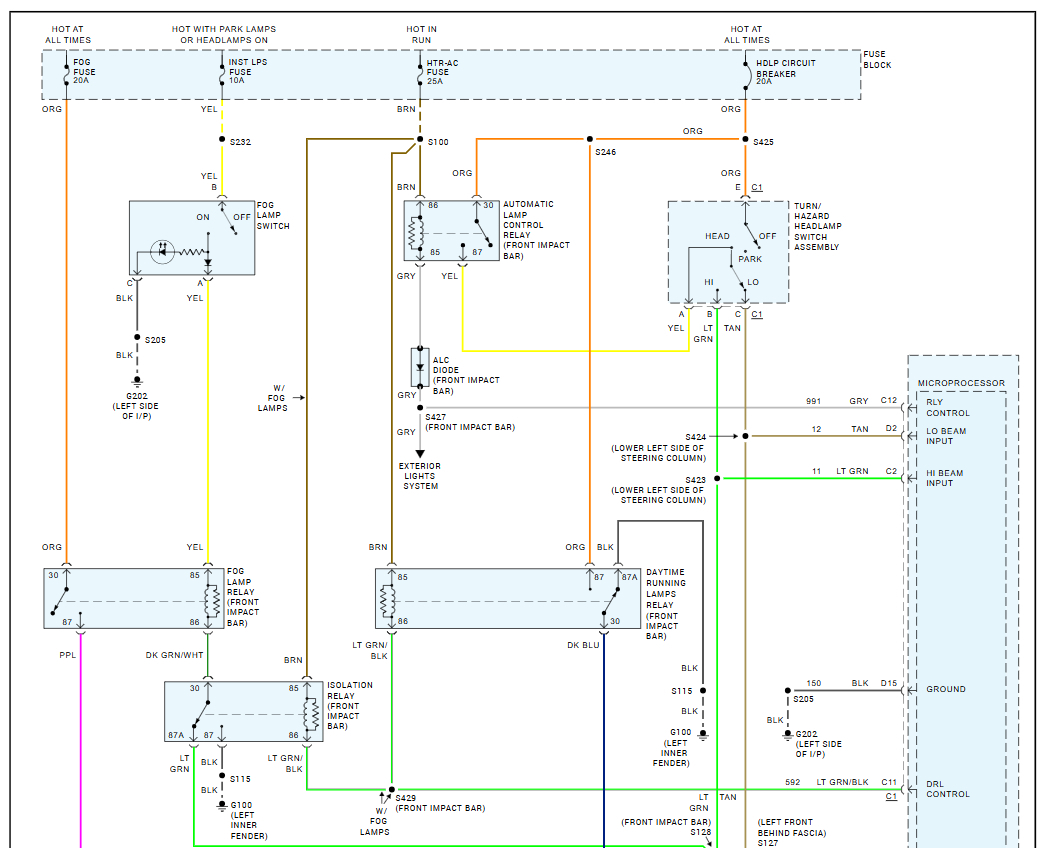

Also, may you have a Wiring Diagram of the ALC System?
Could I (worst case I cannot get a new sensor) disable the system?
Maybe to remove the ALC Relay in the Front Crash bar?
Sep 22, 2025 at 5:17 AM
  • 55,412 POSTS
So the sensor is up by the grill (front bumper area) and you can use the part# I sent you which is just a newer version. If you unplug the sensor the system will be bypassed

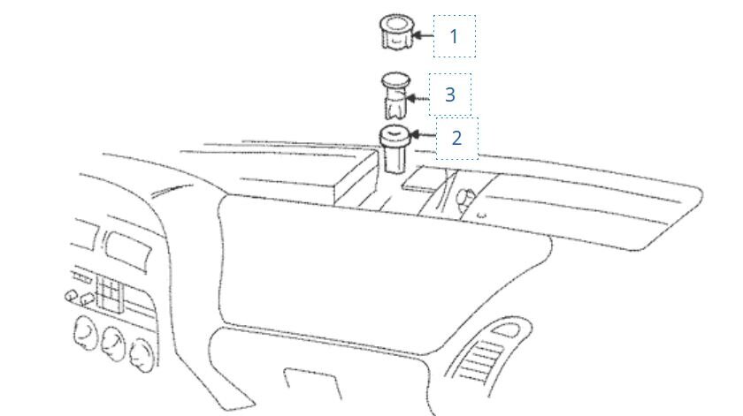

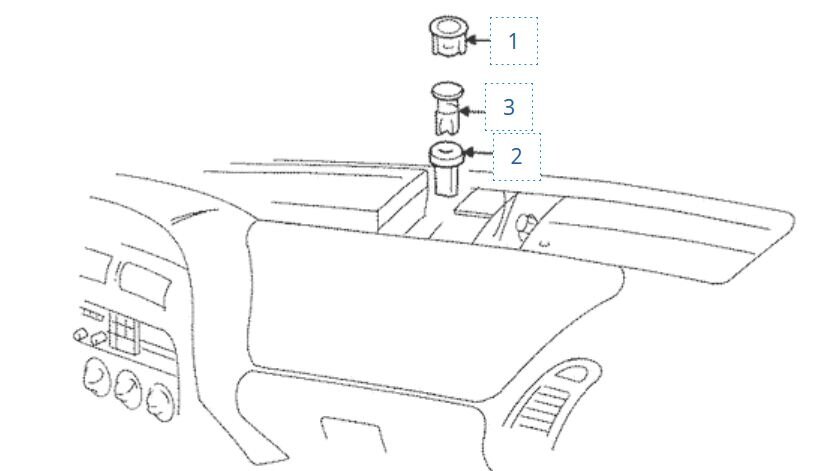

I just searched for the sensor under the hood but could not find any light sensor.
I then took my flashlight and looked for the sensor inside the cabin at the front of the dash.
Most probably I found it.
It is burried under the Windshield Defroster Vents Grill.
You can only see it if you use your flashlight from outside the windshield and point it towards the airvent grill.
See the attached picture I have taken from an Online Parts Catalogue.
It does not sit directly in the middle of the grill but a bit more to the passenger side.
If this is the sensor then I would need to remove the airvent grill and I don't know how to do it without breaking any clips.
Even if successful there is absolutely not much space to remove the sensor since it is half an inch below the grill and the windscreen is more or less directly over it.
This could become a nightmare t replace.
Sep 22, 2025 at 6:03 PM
  • 55,412 POSTS
Hmm, looks like I got some bad info sorry about that. Yep you found it. It should just pop out of there, it is not held in by much. I would try to remove the vent which should help you gain access.

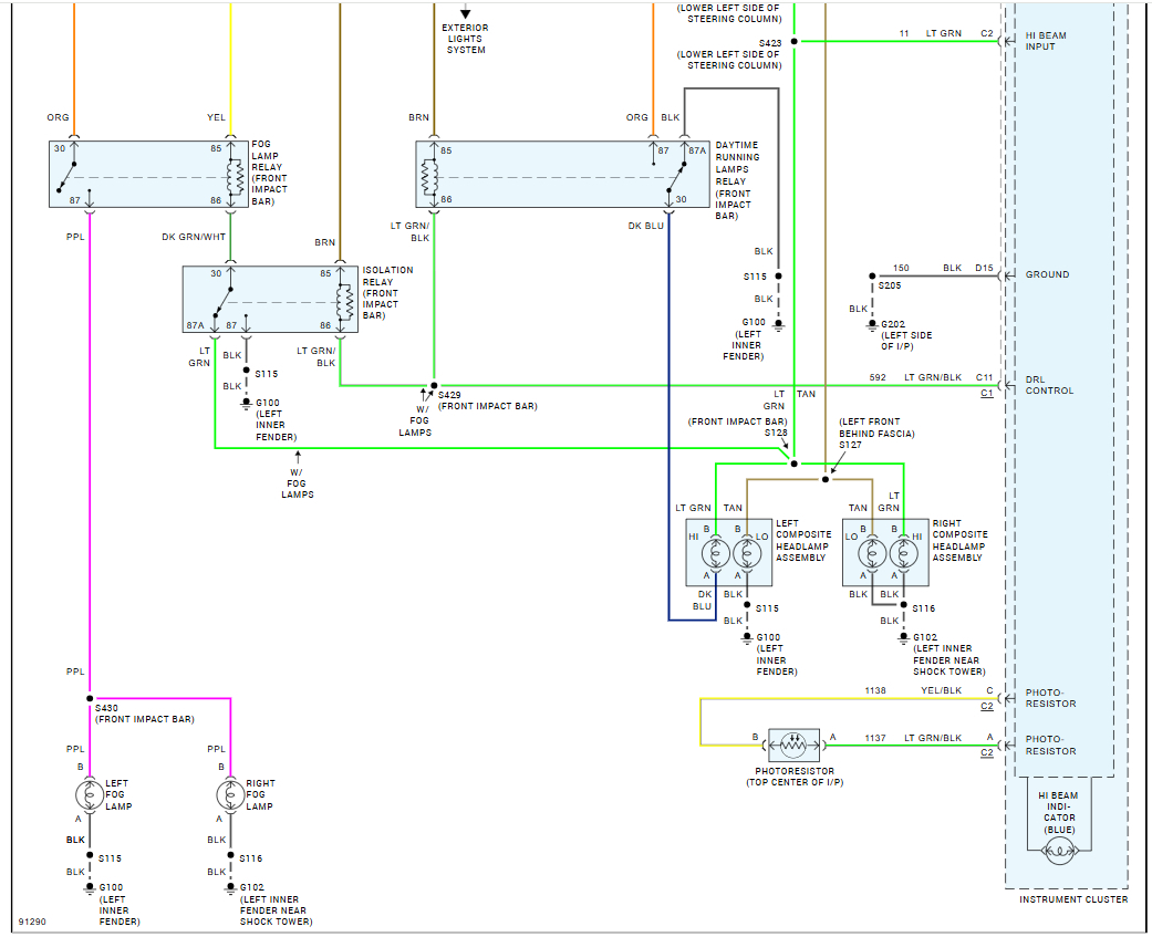

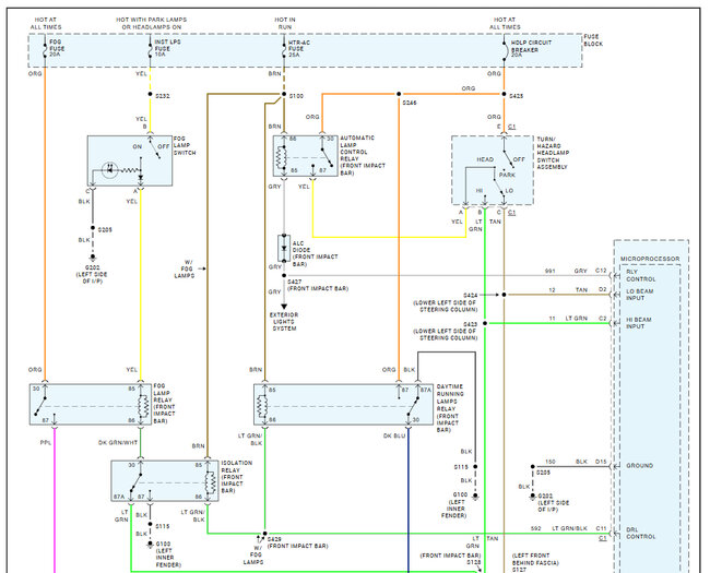

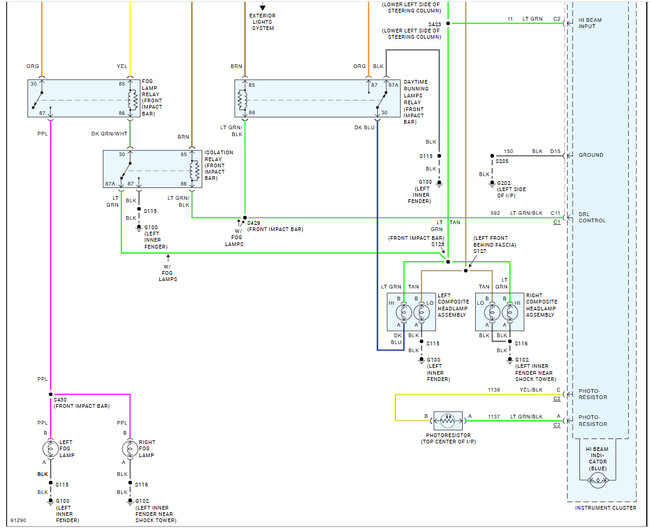

May you also have the Wiring Diagram of the ALC System showing the sensor and relays part o the system?
Sep 28, 2025 at 6:54 AM
  • 55,412 POSTS
Yep, here is the wiring diagrams so you can check it out and see how the system works. Check out the images (below). Please let us know what happens.
Sep 29, 2025 at 2:25 AM
B767_400
  • 36 POSTS
Thanks very much.
Do I understand correctly.... the Instrument Cluster itself controld the ALC as well as the DRL?
There is no BCM or Light Control Module used for that in my 1997 GA?
So to check any Pins I nede to remove the Instrument Cluster (Spedo, RPM, Temp Gauge, ...) beeing able to disconnect the connector to measure any signal?
Sep 29, 2025 at 4:18 AM
  • 55,412 POSTS
That is correct, the sensor goes into the instrument cluster. What are you trying to test?

Yep, that can be a tight fit but you should be able to get a small standard screwdriver to help pop it out of there? Can you upload an image close up of the sensor so I can see?
Oct 9, 2025 at 3:16 AM

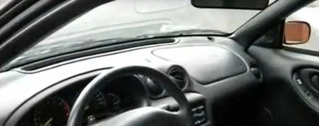

B767_400
  • 36 POSTS
Here is the image.
There more or less no space .
The problem is that on top of the sensor there is a round shaped plastic clip on top what has to be removed first before accessing the sensor.
And this plastic clip is approx half an inch below the vent grill.
Oct 12, 2025 at 2:35 AM
  • 55,412 POSTS
Yes that is the vent grill, you should be able to remove the whole grill piece in one go, look for screws but if you cant find any it should just pop out of the there because it uses clips, let me know.
