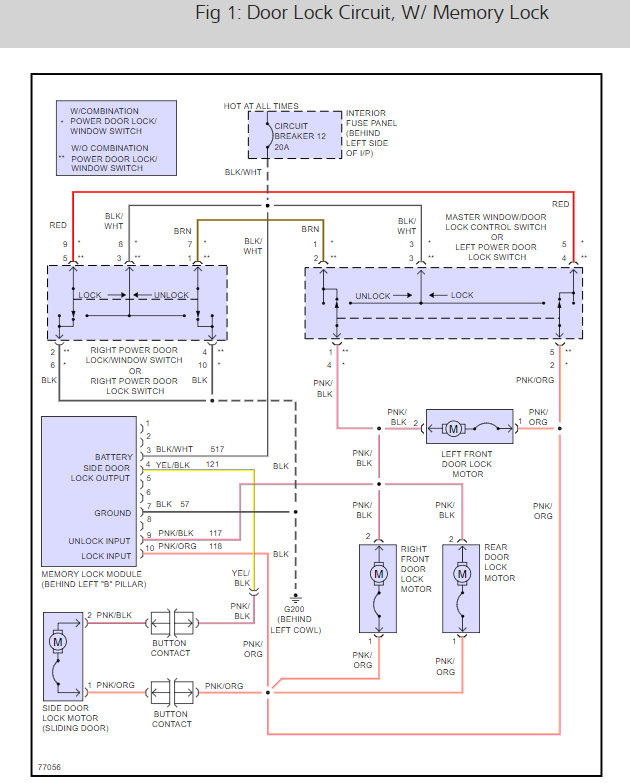

The door locks will keep going on and off.

Is sounds like the lock module is having a problem. Here is the location of the module and the wiring diagrams so you can see how the system works.
lock module - Behind Left Side Quarter Trim Panel
