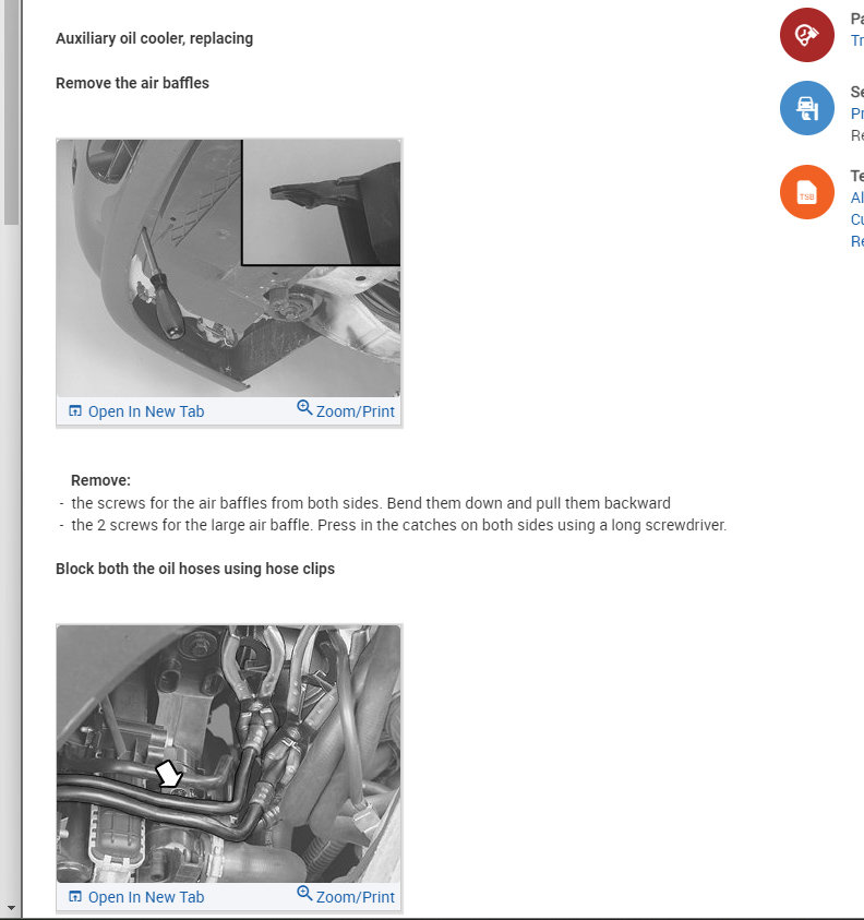

The green clip broke what's an easy way to get the line out?
Nov 17, 2021 at 8:27 AM

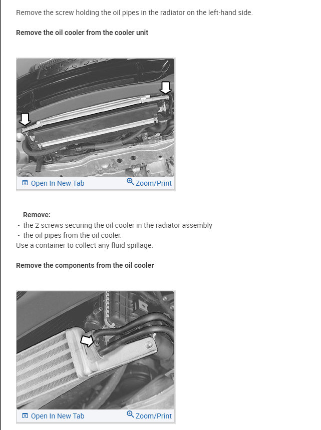

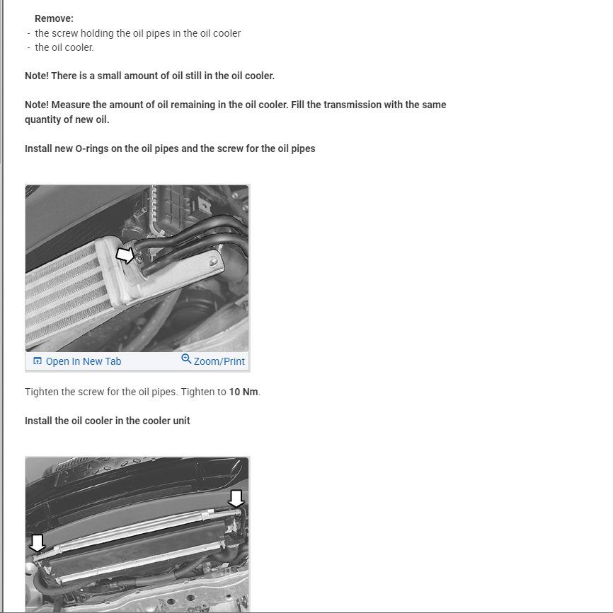

Can you get a picture of the green clip that you are looking at? I suspect this is a quick connect style of clip, but the manual does not have this style connector holding the cooler lines on. They show the single block with a screw in the center.

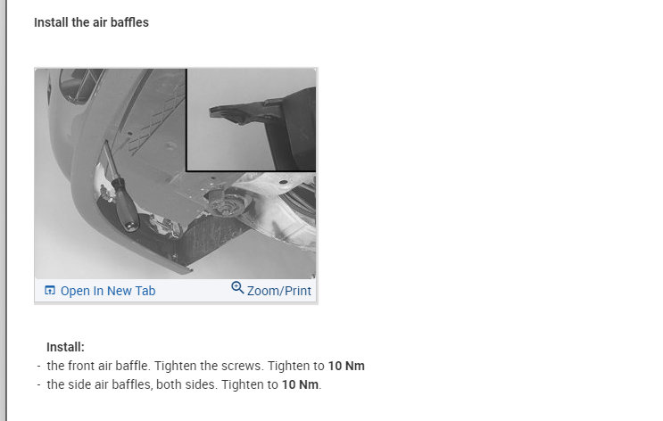

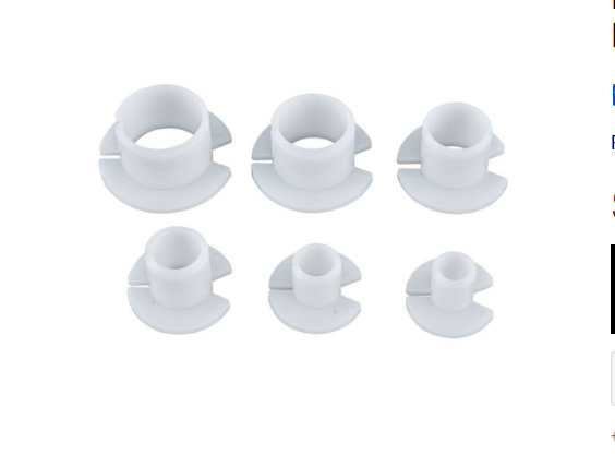

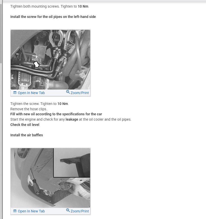

I am attaching the process below from the manual for your review but please get a picture of what you are looking at because if it is the quick connect style you need to use fuel line release tools. I added a picture below of these as well.
However, seeing this will help confirm what you need. Thanks
