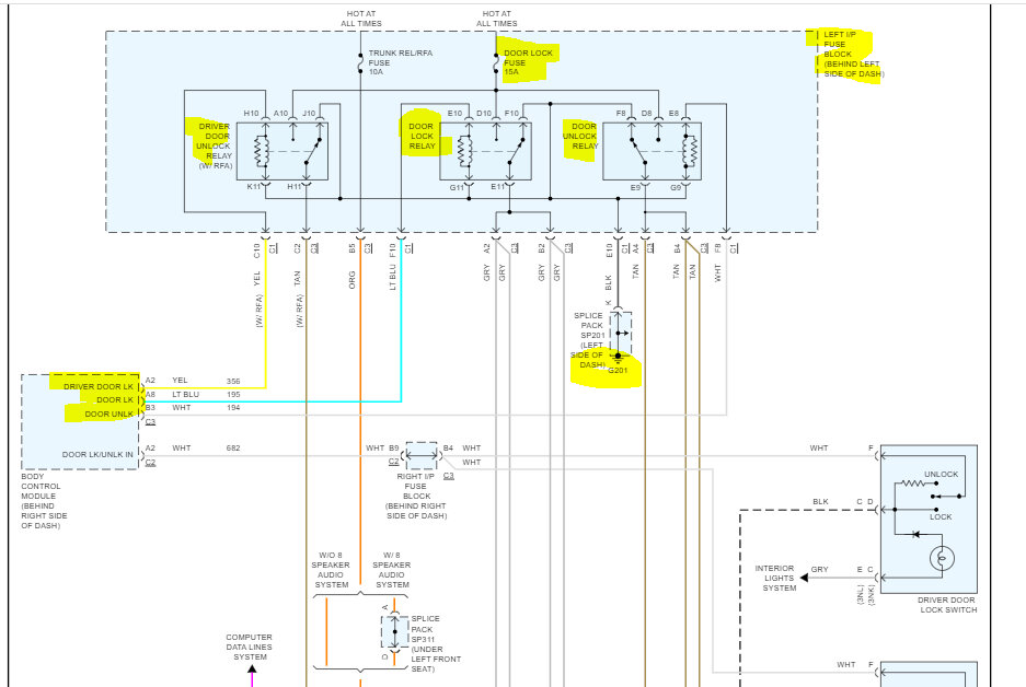

Hi, I've noticed that my automatic locking system and remote entry hasn't been working. If I want to lock or unlock my doors, I have to use my key or push the lock closed with my finger. I've tried replacing the minibuses but that hasn't helped. I have been messed over by mechanics now i want to do it myself. I need some help.

Which fuse did you check? Did you confirm there was power to the fuse and from it? If not, try that first.
If that checks good, there are three relays that may be causing an issue. Check these next. If there is a different relay having the same part number, switch them. If there isn't, here is a link that explains how to test a relay:
I attached a pic below of the wiring schematic. Check these things and let me know the results.

Hi, I checked the fuses and relay's and it turns out that 2 of my relays ( the lock and unlock ones) are corroded and after switching them with the remote locking relay it. Thank you so much for your help!
