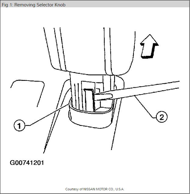

How do I remove the shifter knob on this vehicle?
Feb 25, 2017 at 7:41 AM
KHLOW2008
Experienced Mechanic
41,812 POSTS
1. Slide the selector knob cover downwards with fingers to reveal the selector knob latch.
2. Gently pry the selector knob latch outward to release then lift the selector knob up to remove.
