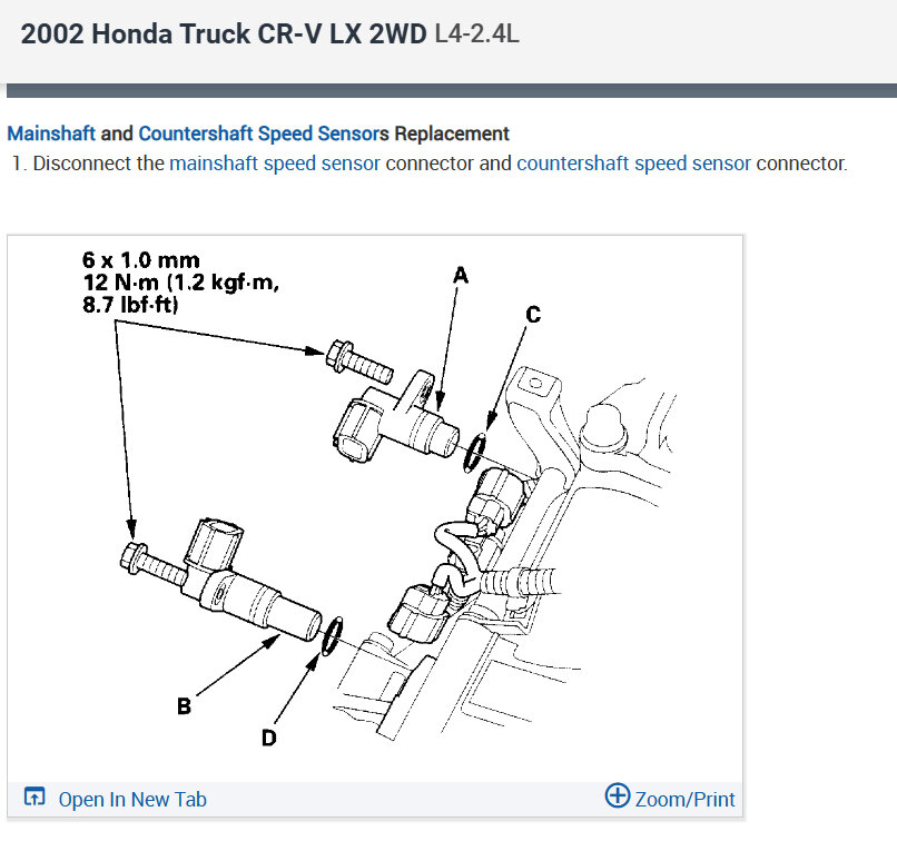

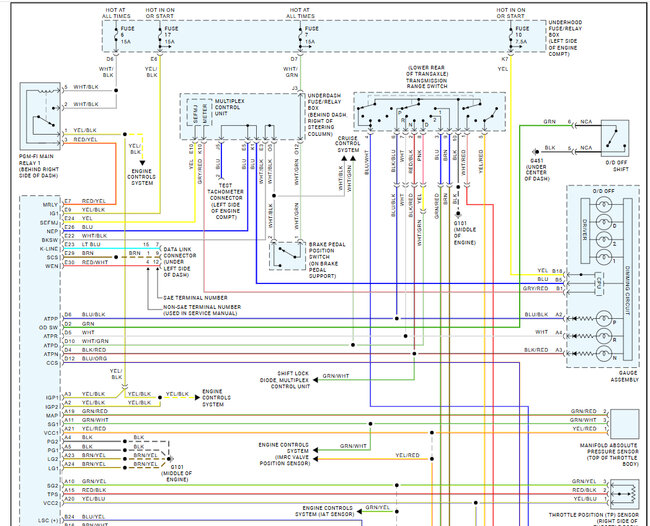

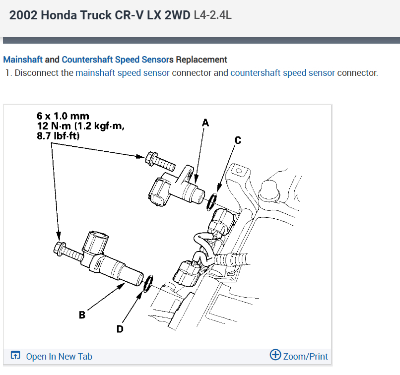

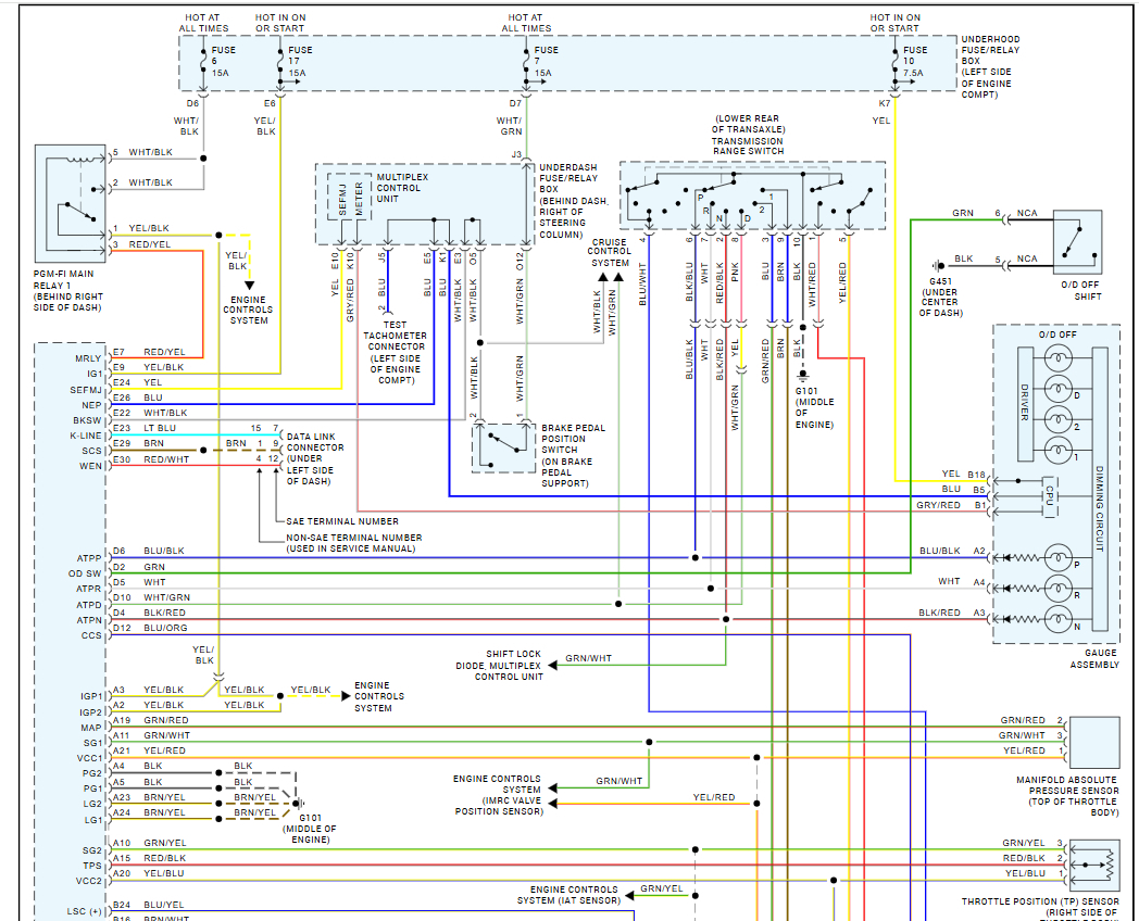

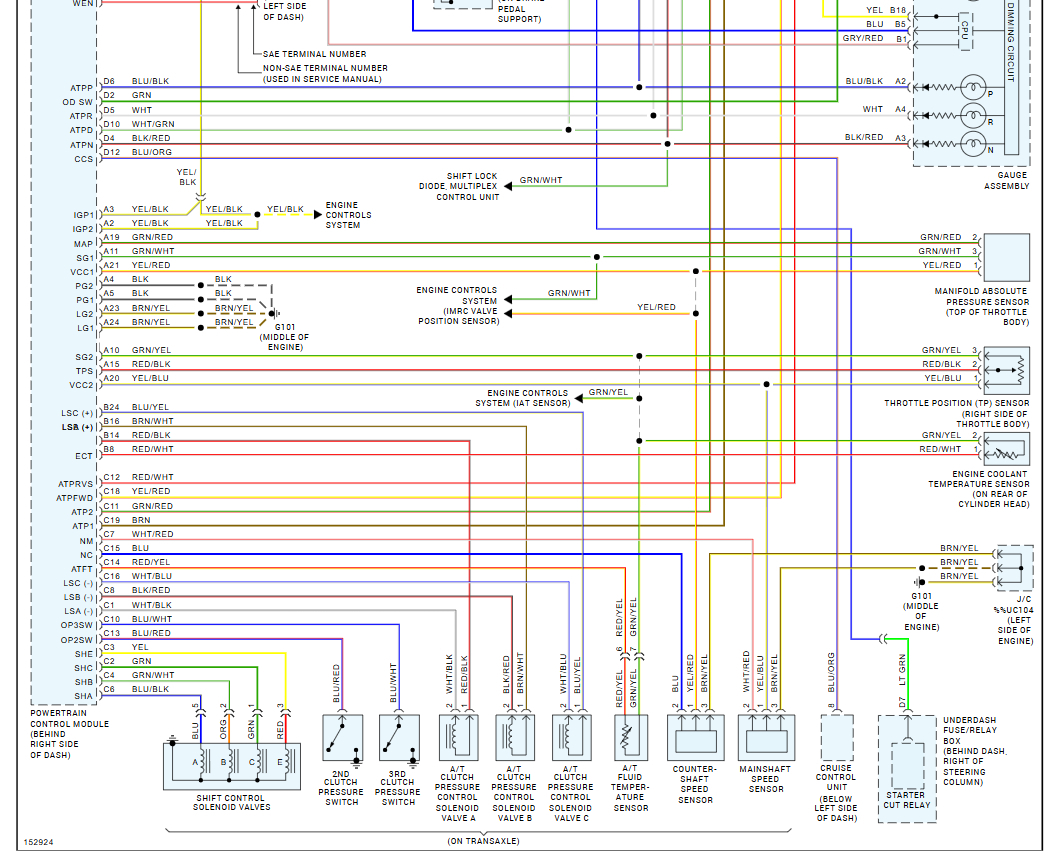

So, what happens is the front fluid pump can go out and cause solenoid codes or you have a bad connection. Also, with the p0730 have you replaced the counter shaft sensor? I have seen this sensor get weak and cause this code. Here is a guide to help check the connection and the wiring diagrams so you can see which wires to test.
Oct 30, 2024 at 2:08 AM
ALOHA168
  • 52 POSTS
I'm still confused. Do you mean the P0420 is related to the auto trans codes? I also heard the rattling sound from the driver's side (the transmission) before. And the catalytic converter is on the passenger's side. On the main shaft and countershaft speed sensors you mentioned, I can't find them online even at the Honda parts websites. What are their correct names or part numbers to search for? If I can't find any, should I just remove and clean them and put them back? Is there any way to test them while removed? The main is A and counter is B? What about the cracked flex plate now?

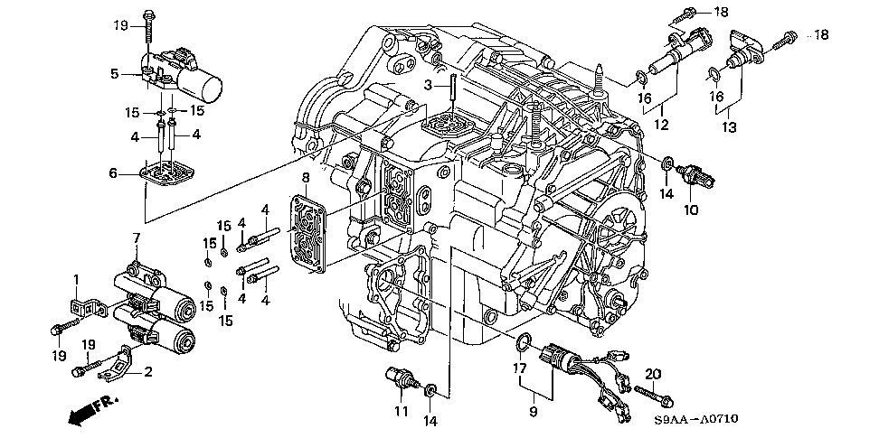

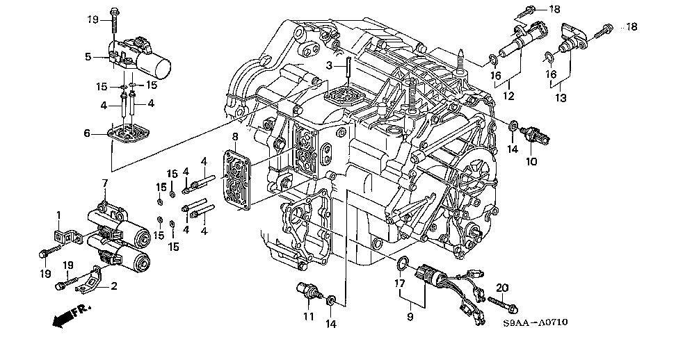

I checked again today and noticed a have a small leak at the cover bottom of part #17 of the picture attached which I've never noticed before. And it's in the general area where I heard the rattling sound before. Partt 17 is the plug which attaches to 4 connectors of solenoids A,B,C&E(no D).I've found a set of these solenoids online with 5 solenoids(A,B,C,D&E) which they say will fit my car).Should I give it a try,I just use only 4 solenoids?
Oct 30, 2024 at 8:36 AM
ALOHA168
  • 52 POSTS
Sorry,it's #17 and 9 in the picture.

The pressure C malfunction can be a pressure issue as well and with an incorrect ratio it is telling us the transmission may need to be rebuilt FYI.
