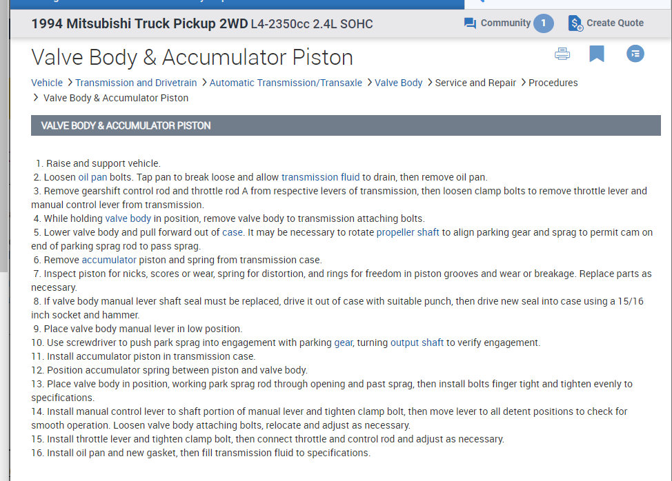

automatic transmission drain plug
1994 MITSUBISHI MIGHTY MAX
100,000 MILES

does it have a drain plug or do i have to drop the pan to drain the fluid?
Jul 13, 2021 at 9:44 PM
You do not have a drain plug in this pan. Take a look at the attachment below and that will show that it says when remove the valve body that you need loosen the pan and allow the fluid to drain.
Here is a guide that will help with general info if you or others in the future need it:
Below is the process. Please let us know if you have other questions. Thanks
