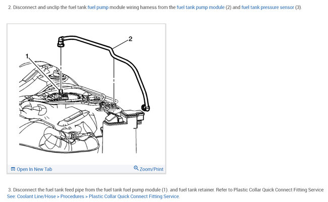

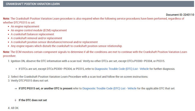

Car won't start after it auto stops wait ten minutes it will start.
Jul 11, 2019 at 9:15 PM
  • 55,714 POSTS

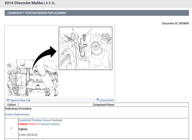

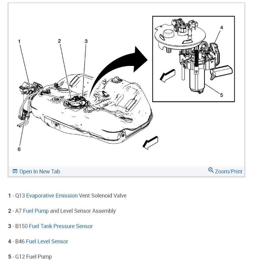

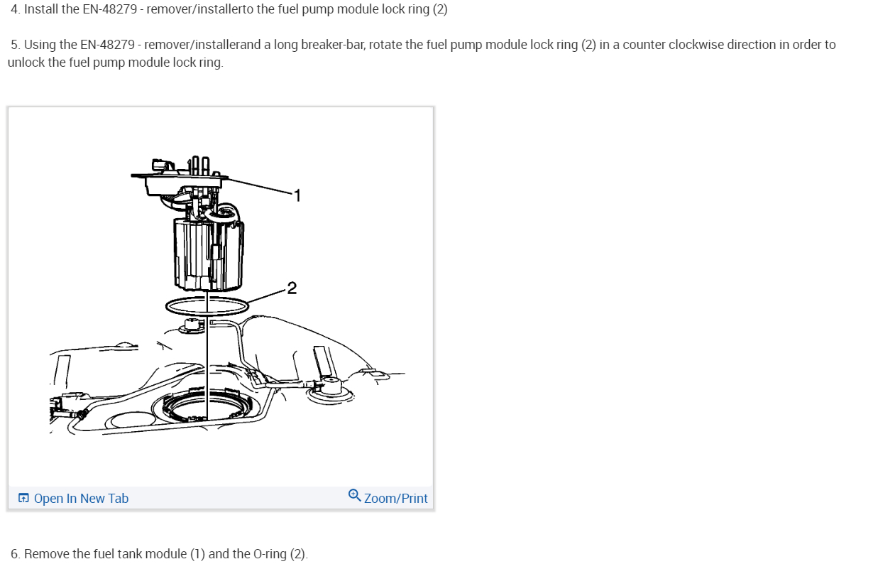

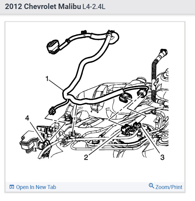

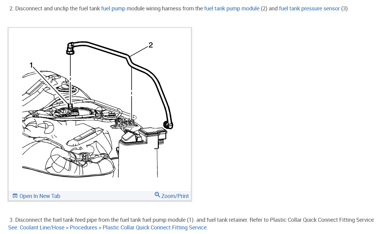

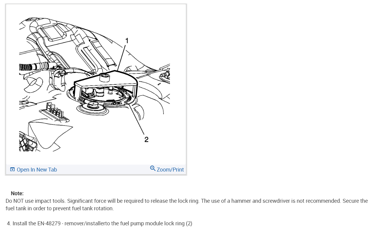

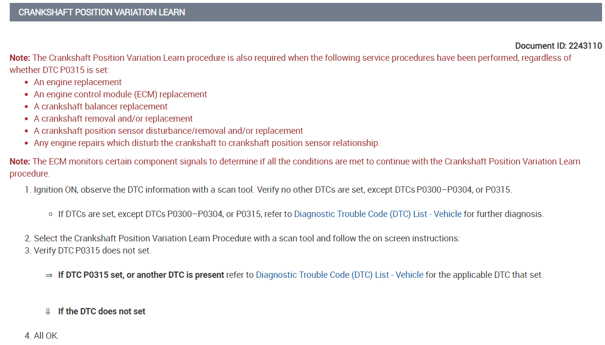

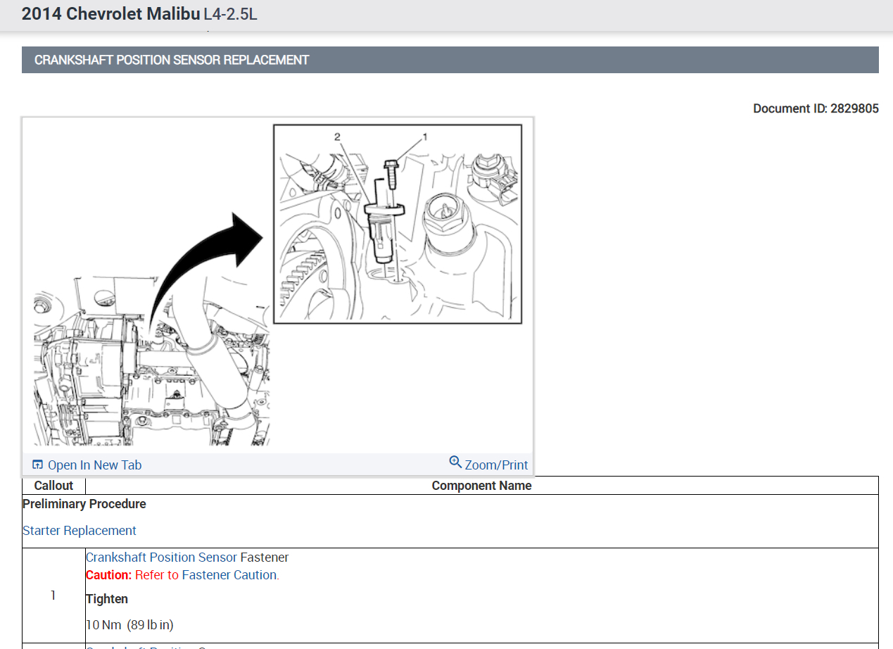

This sounds like a fuel pump or the crankshaft angle sensor has gone out. When you turn the key to the on position without cranking the engine over can you hear the fuel pump run in the tank for 5 seconds?
Check out the diagrams (Below). Let us know what happens and please upload pictures or videos of the problem.
Jul 13, 2019 at 6:34 AM
JEREMY BORSH
thanks for the guide. I found out the fuel pump was no good, car runs great now. :)
