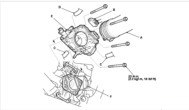

  • 54,832 POSTS
Nope, a downstream oxygen sensor will not cause the engine to stall. I would service the throttle body and then use a smoke machine to test for leaks. Here is a guide and video to show you how.
and
https://www.youtube.com/watch?v=LRKWV4Are5c&t
Here is how to service the throttle body on your car. Check out the images (below). Please let us know what happens.

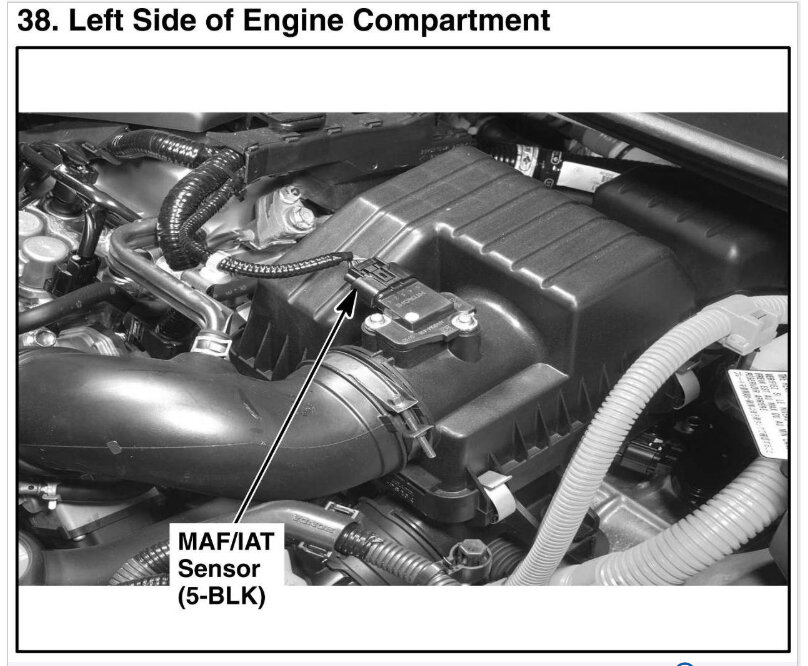

  • 54,832 POSTS
Yep, that is a lean code, This is most likely cause by a bad MAF sensor which is common. Here is a guide to go over and the location of the sensor, clear the codes once the job is completed.
https://www.2carpros.com/articles/repair-lean-mixture-codes-p0171-or-p0174-on-some-manufacturers
Check out the images (below). Let us know how it goes
