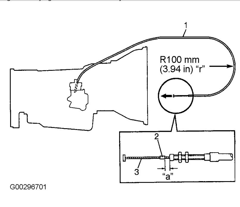

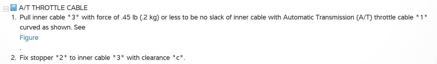

Hi, I got a Suzuki Jimny for my girlfriend and when you pull off the throttle it is like the kick down cuts in and it revs its head off, sometimes changes and sometimes does not. Please help me.
Feb 26, 2016 at 8:53 PM
HMAC300
  • 48,601 POSTS
We do not show that model in our manual,l but here is adjustment of throttle cable from a Grand Vitara. Also, scan for codes and check for a broken or binding throttle cable.
