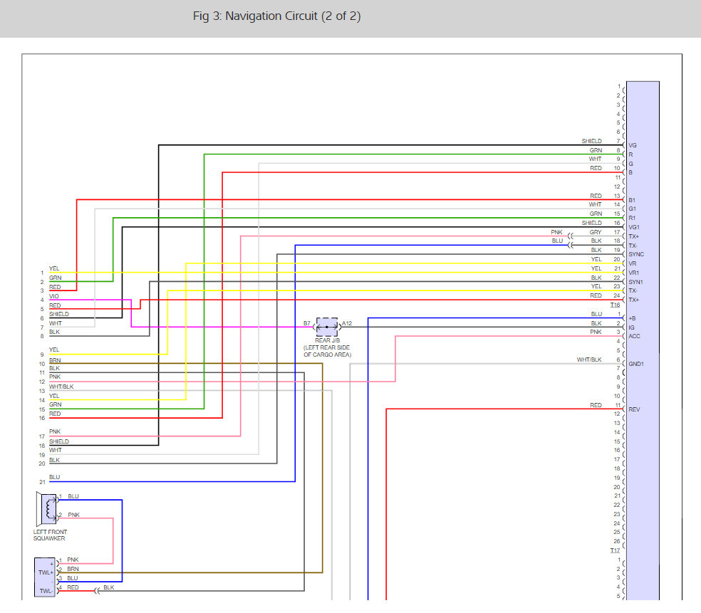

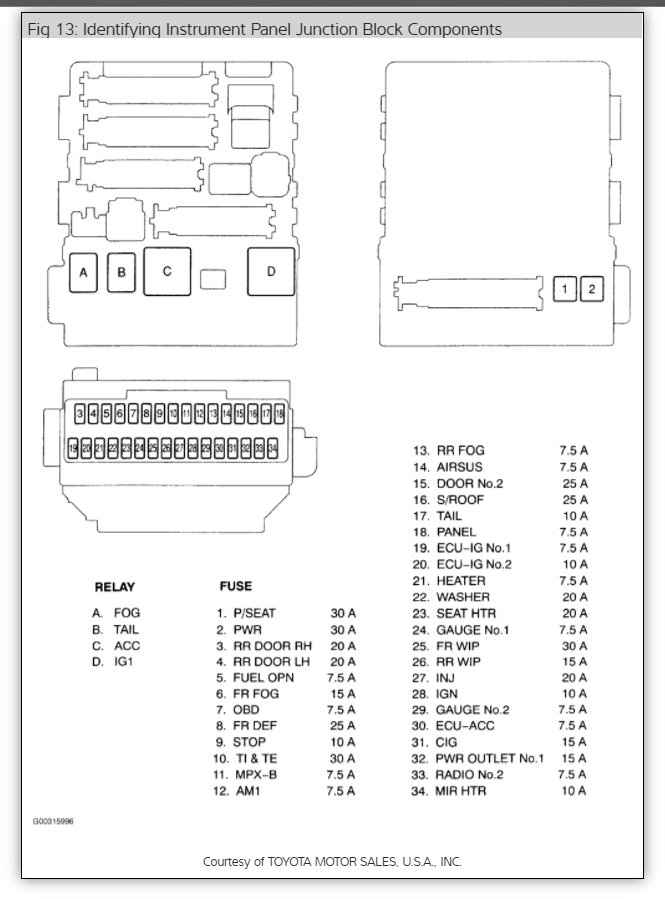

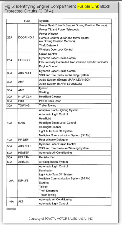

Auto dimming mirror is currently working fine. But there is problem with compass getting stuck with letter C. I know it is meant that to calibrate this compass. Could you tell me how to calibrate? Or something happens? Thanks.
Oct 24, 2017 at 2:03 PM
  • 55,554 POSTS

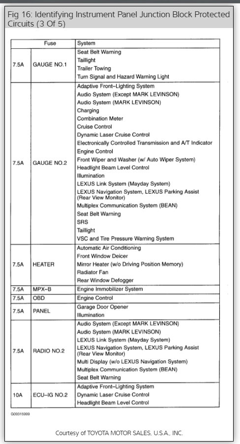

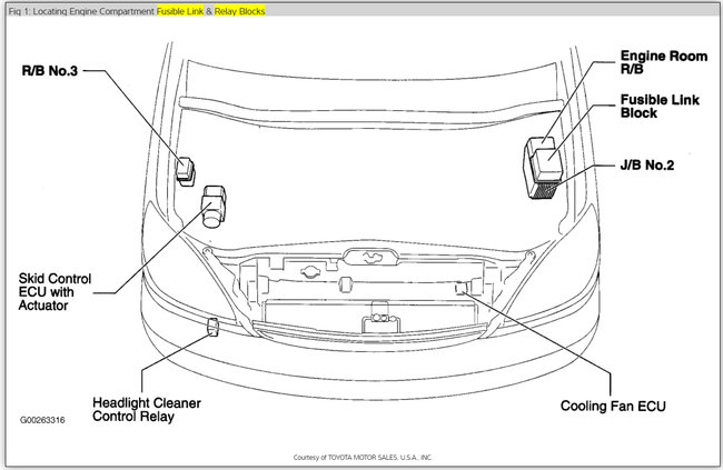

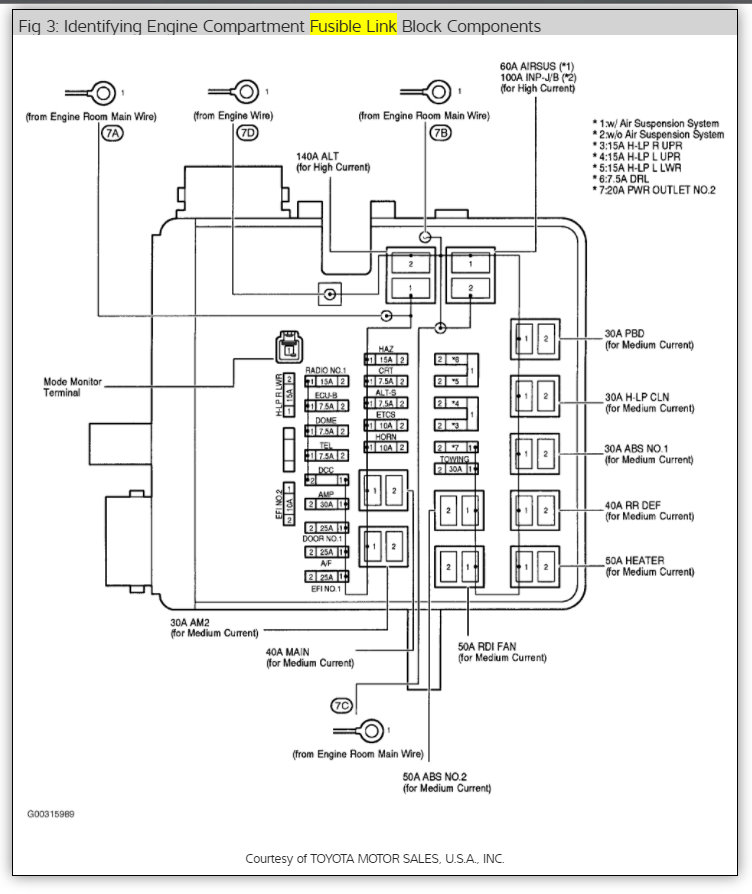

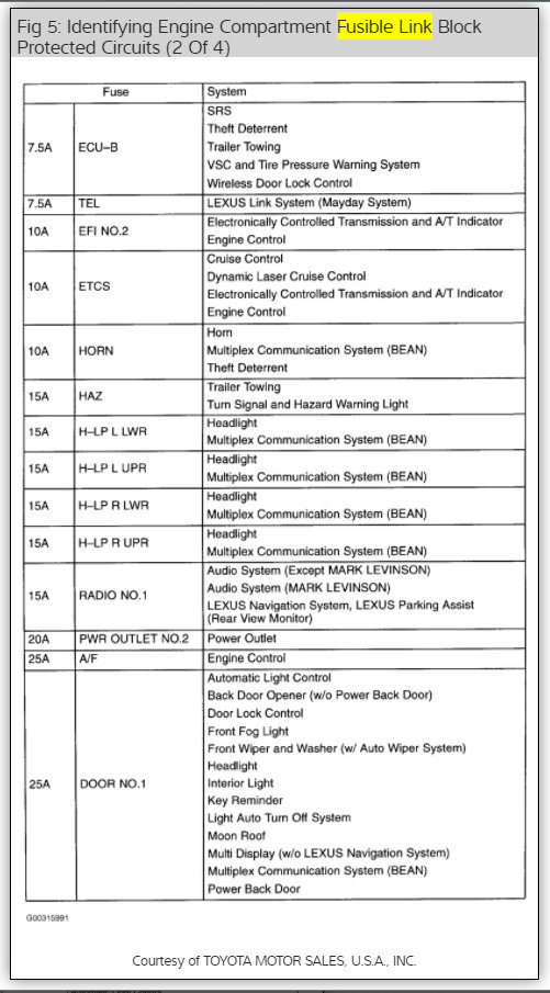

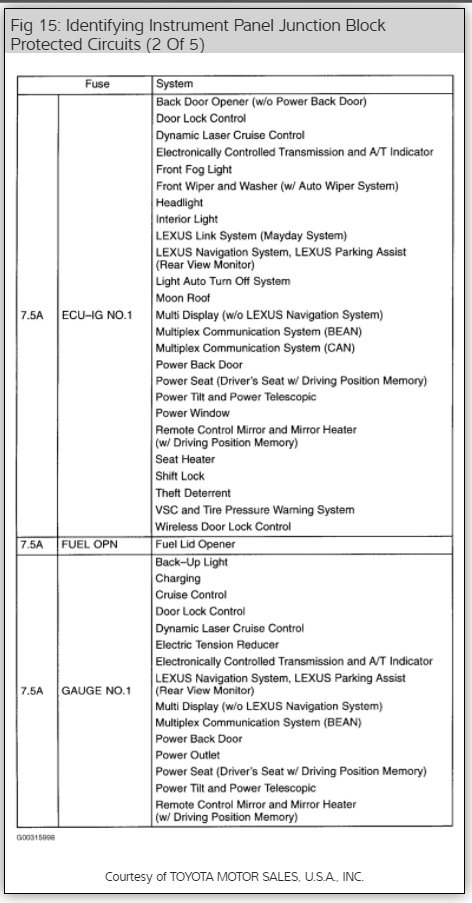

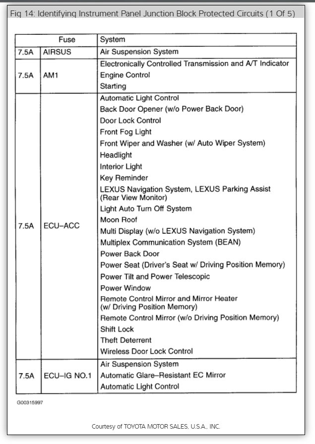

It sounds like you have a fuse out, lets start there first.

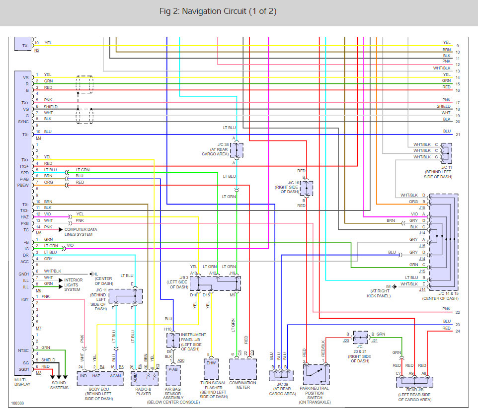

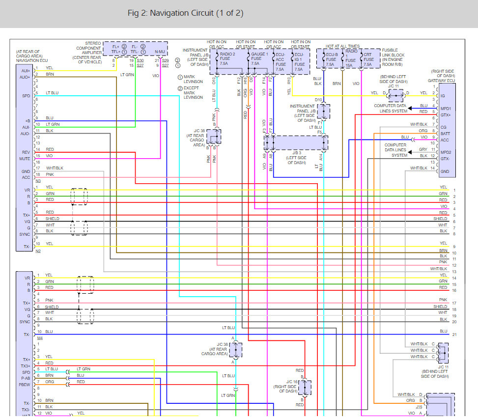

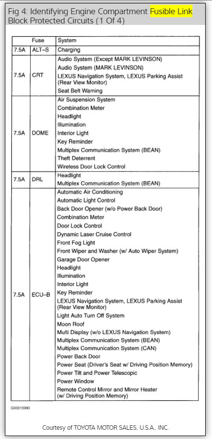

Here is a guide and some diagrams (below) to help you get the job done:
If all fuses are okay I would remove the negative battery cable for five minutes and then reconnect. This might reboot the system.
Please let us know what you find. I'm interested to see what it is.
