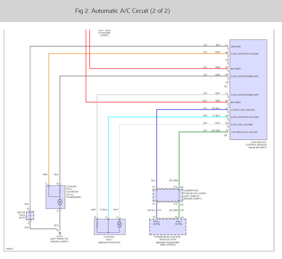

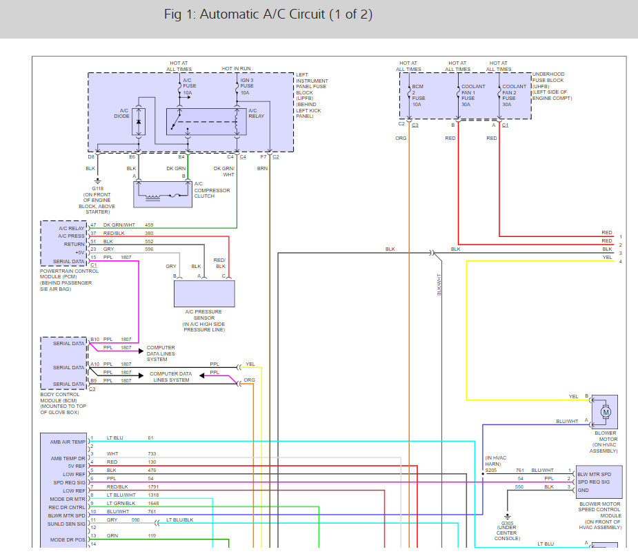

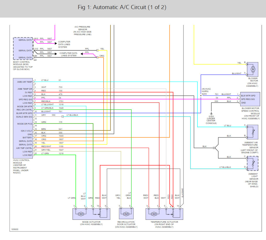

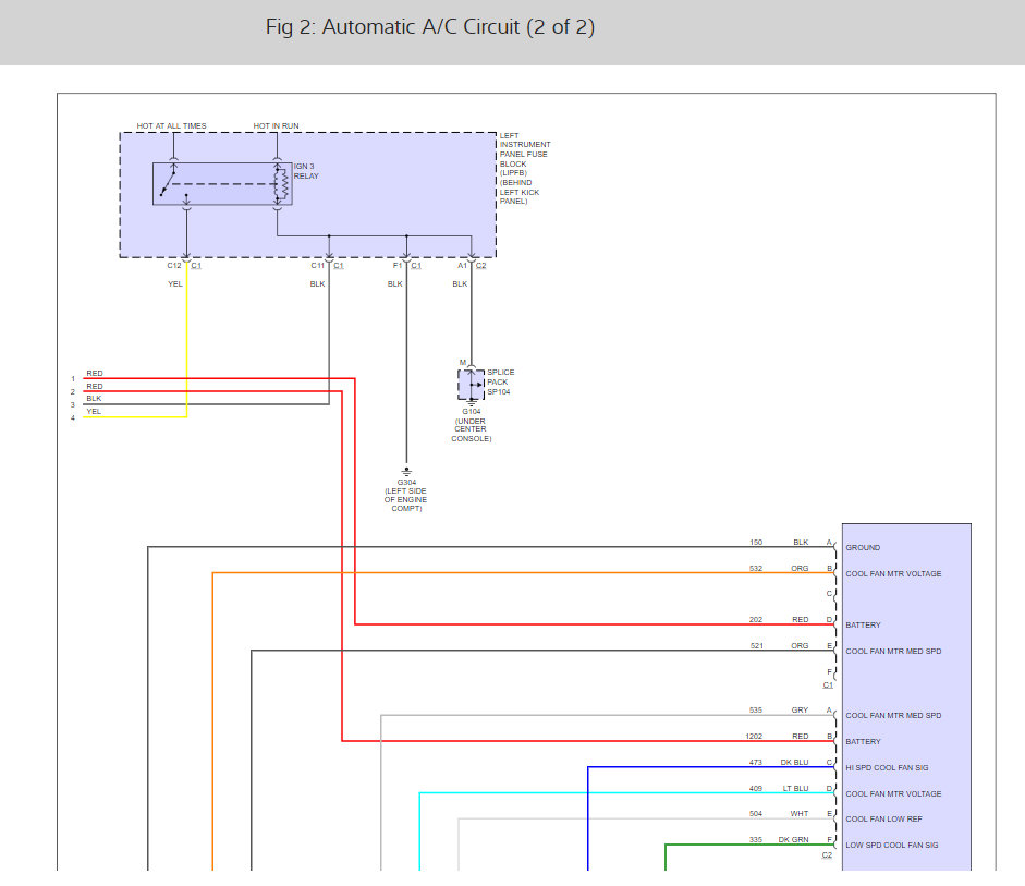

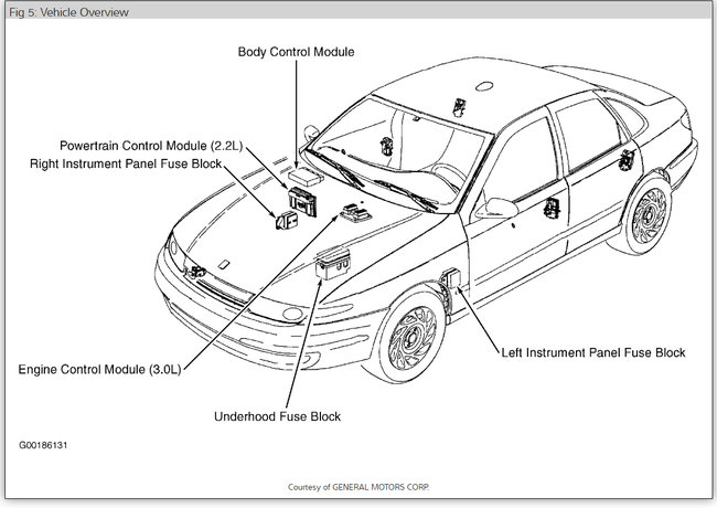

Good information, the lighting issue with the AC problem is a clue the BCM is going out or the control head is shorting back feeding the BCM. The BCM shares data which will cause the AC to fail at the same time. Here is the wiring diagram so you can see how the system works and the location of the BCM.
I would try a used control head first then the BCM which may need to be programmed in for about $130.00 at a shop.
