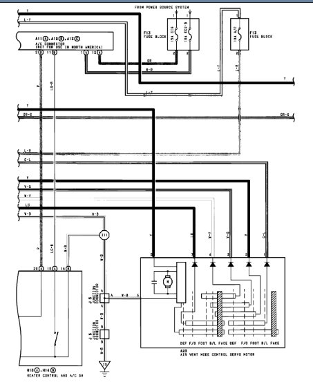

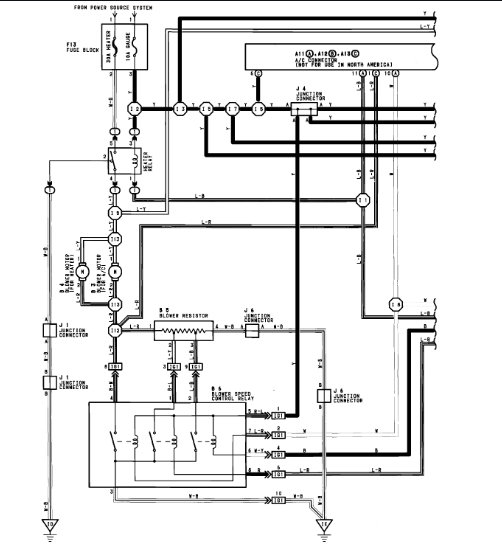

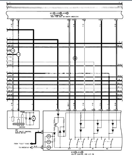

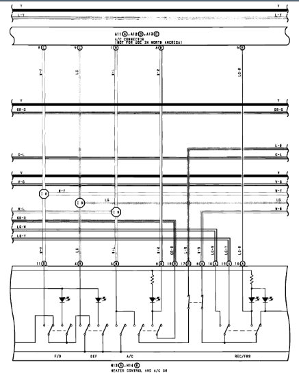

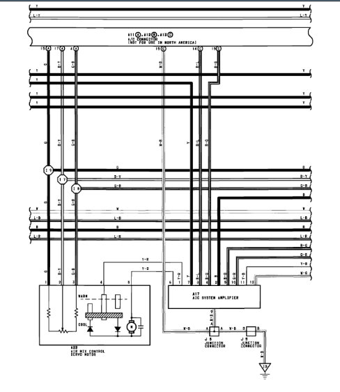

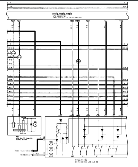

The only thing I was able to find is the OEM wiring schematics which can be difficult to follow. Take a look through them and let me know if they help.
I do have better schematics for the manual control, so let me know if that would help in any way.

The wiring schematic I sent is the only thing I am seeing. I'm not sure where you are located and if there is a variation, but when I go to Toyota Land Cruiser in my manual, I only have one option. Are you in the US?
