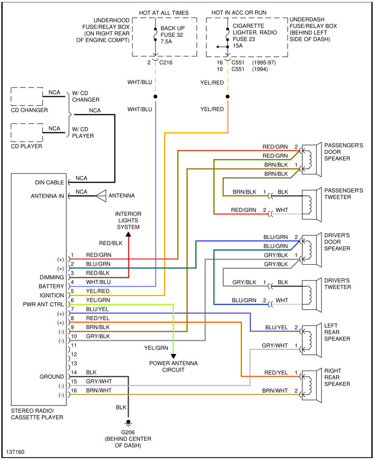

I recently bought this gem, knew it did not have a radio when I bought it. Got a double din android to install. There was no wiring harness left from the previous owner. I have every wire accounted for except this lonely yellow with green stripe there. Unit powers up but no sound. Please help, I'm very confused.

Please see the radio wiring diagram below.
The yellow/green wire is for the power antenna control
Suggest checking that speaker wiring is connected correctly.
Also check that both fused supplies are present.
Please let us know how you get along.
Cheers, Boris

So, does that mean I will hook the blue power antenna to that or what does that need to tie into to complete the circuit? And thanks very much btw.

The original power antenna has three wires.
Black = ground.
White-red = Power, constant 12V.
Yellow-Green = wire from the radio telling it to go up/down, 12V when radio is on, 0V when off.
Cheers, Boris
