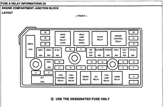

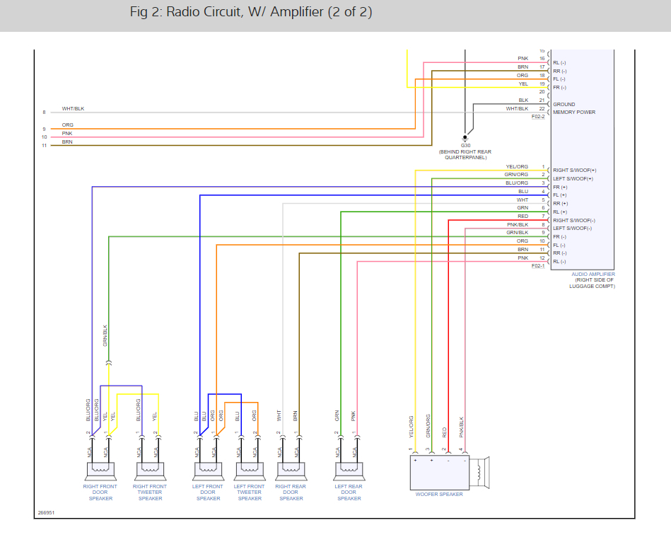

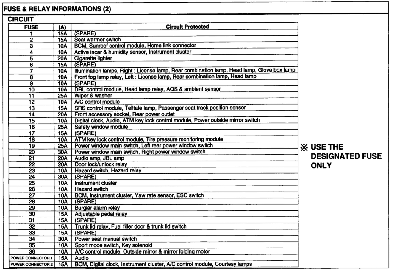

Factory stereo turns on but no sound from speakers. it just stopped working.
Jun 10, 2020 at 6:08 PM
  • 55,859 POSTS

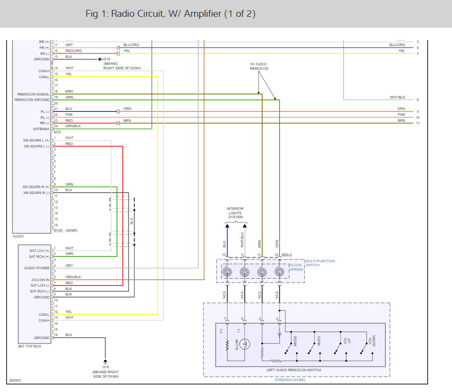

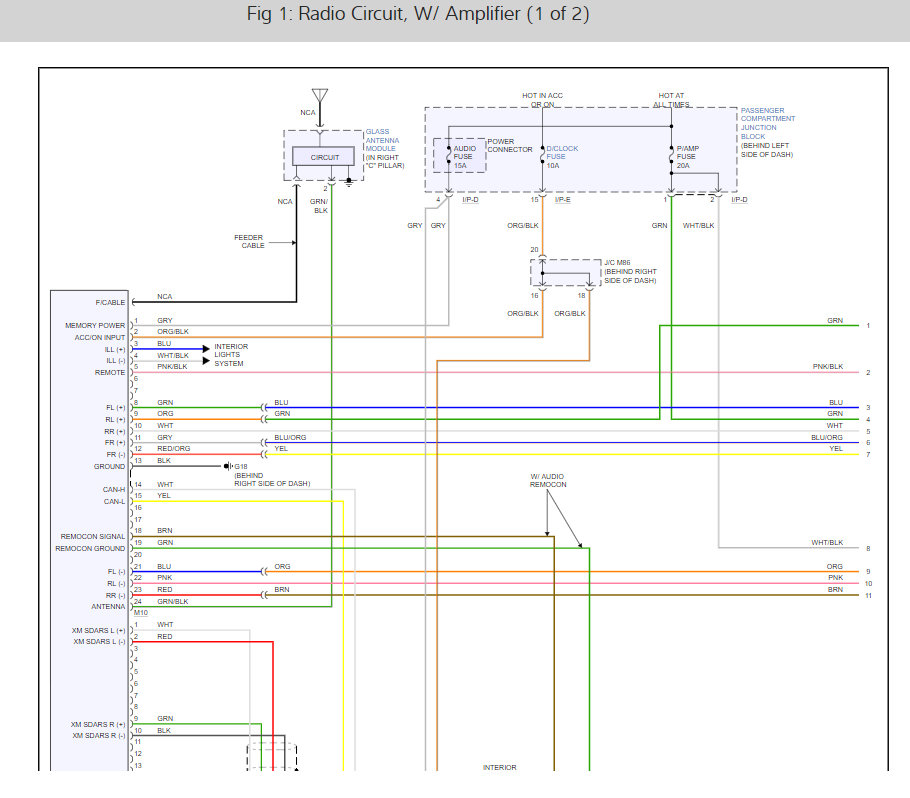

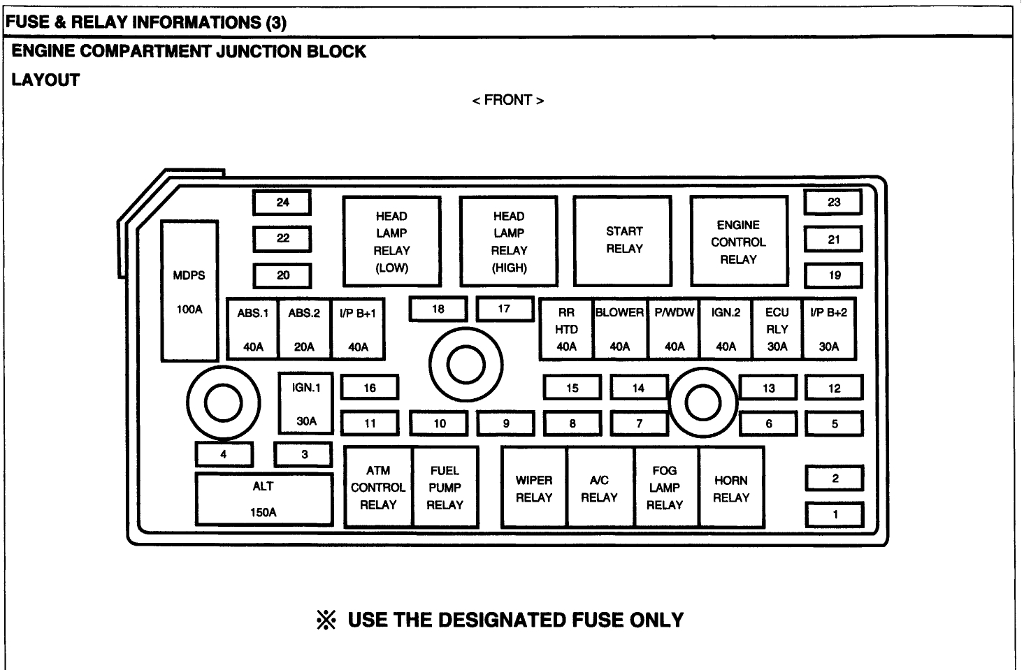

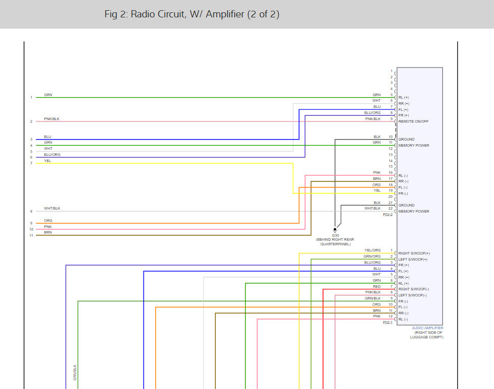

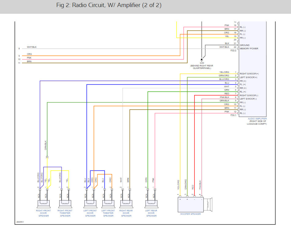

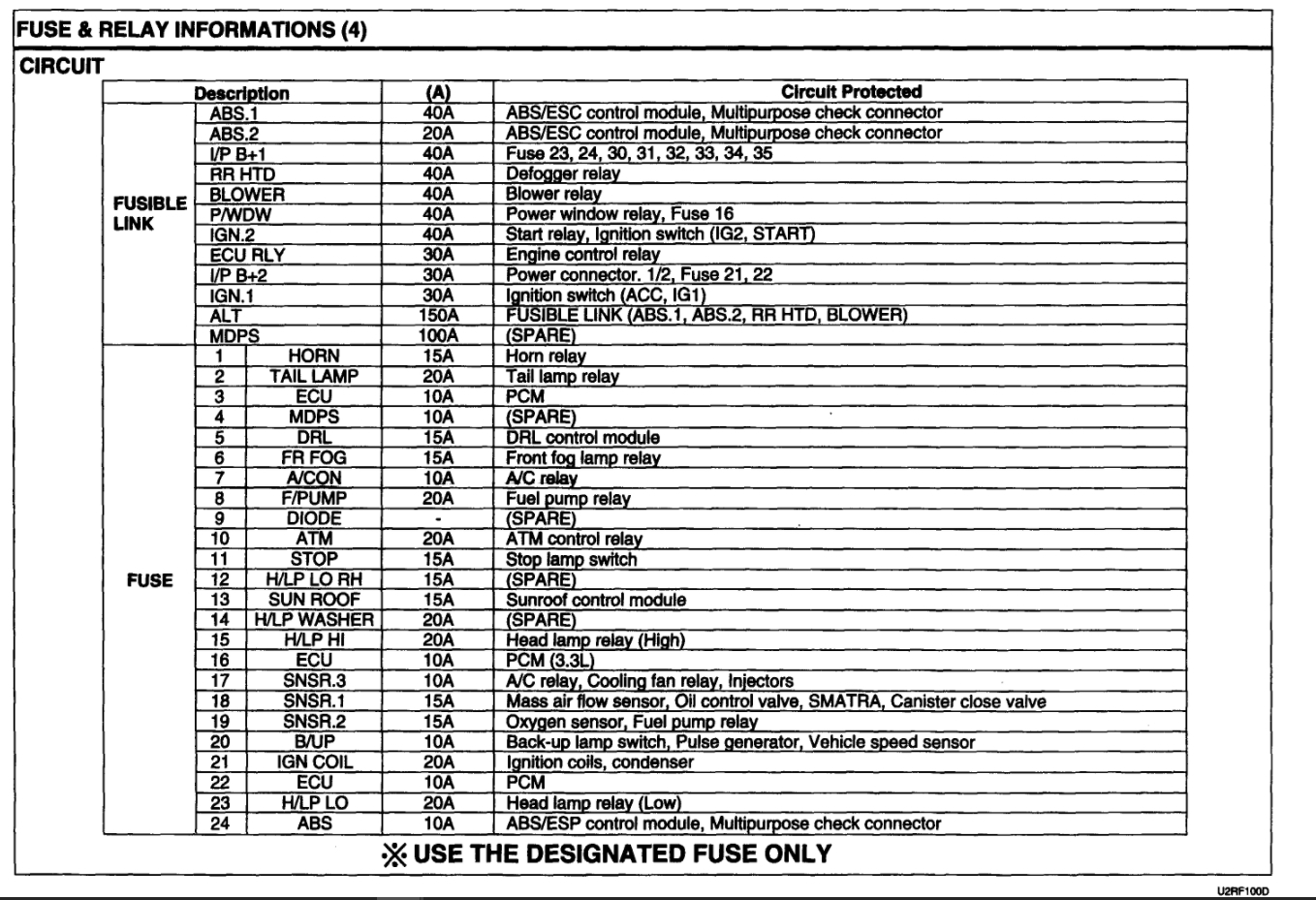

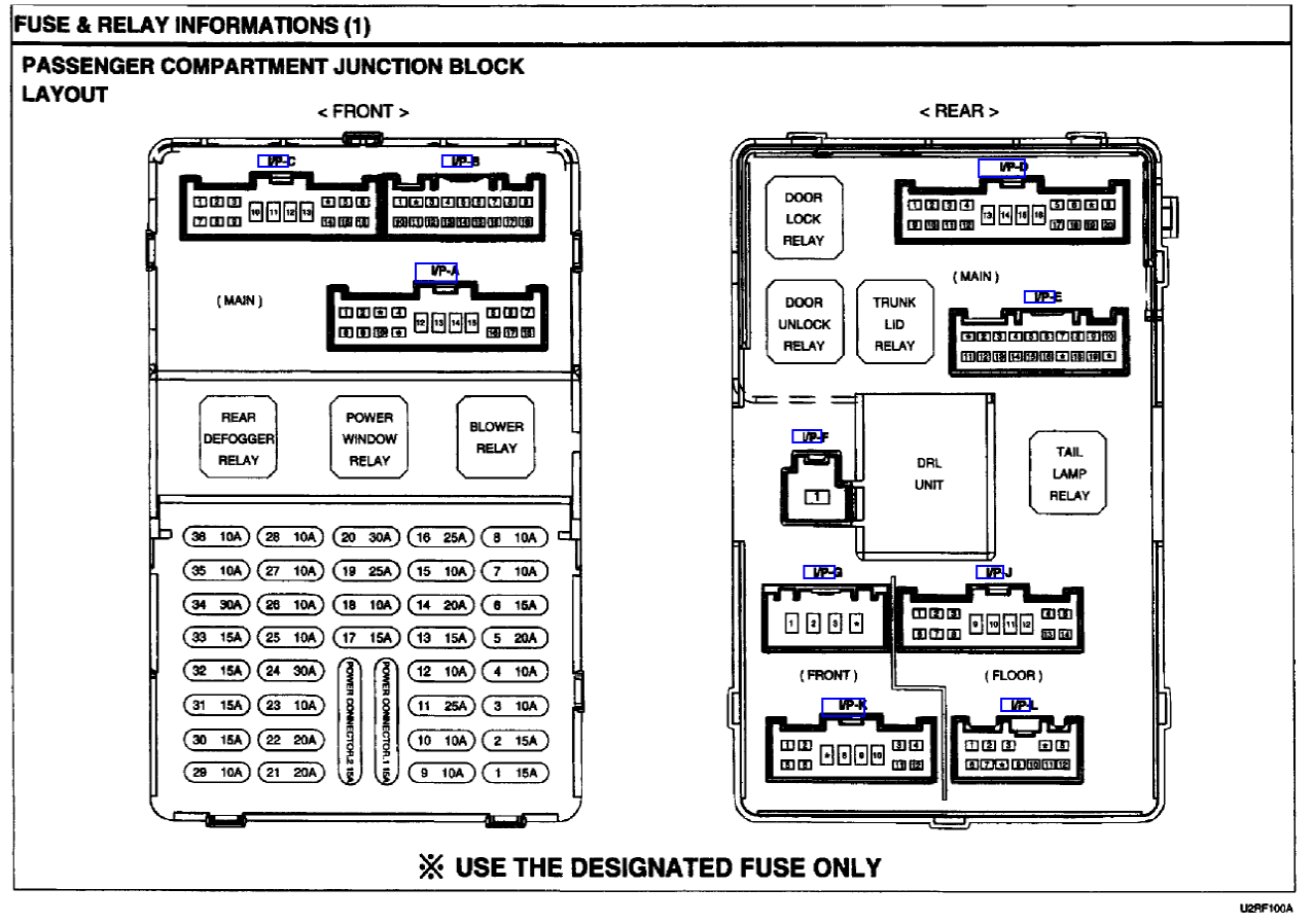

There are two fuses we need to check (audio - p-amp). here is a guide to help test the fuses and the fuse location as well as the radio wiring diagrams so you can see how the system works:
