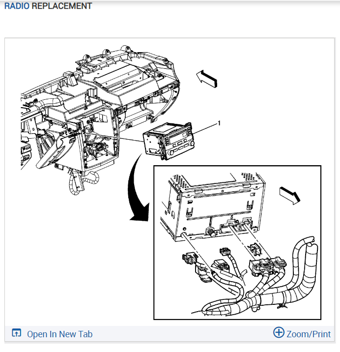

Front 2 speakers no audio but back 2 work fine.
Mar 16, 2024 at 4:45 AM
  • 55,433 POSTS

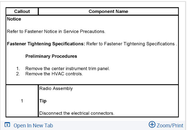

I would check the front to rear fade adjustment on the radio first. If that is okay, it sounds like the amplifier inside the radio is having a problem and is not working for the front to speakers of the system. If this is the case, I would replace the radiator with an aftermarket unit or a used stock replacement by searching Ebay. Here is how to change the unit out. Check out the images (below). Please let us know what happens.
