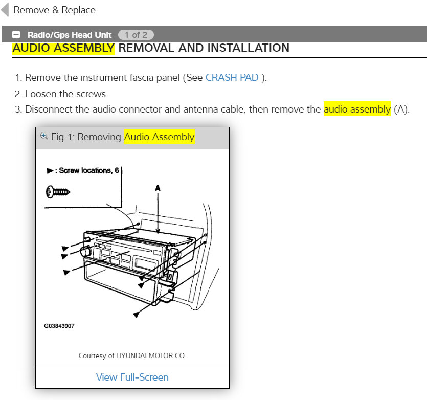

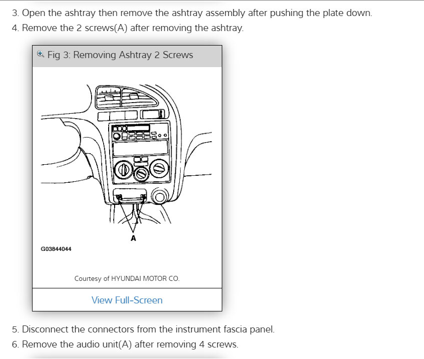

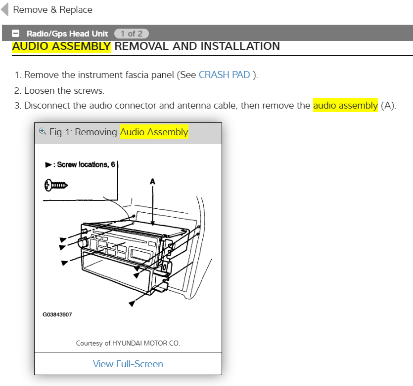

What are the steps for removing the stock radio?
2000 HYUNDAI ELANTRA
149,455 MILES • 2.0L • 4 CYL • 2WD • AUTOMATIC
AZDANNO04
  • 375 POSTS
If you can send me steps on taking out the stock radio. I purchased a Dual CD deck from Walmart for my car. I also purchased 18-gauge wiring for the speakers.
Aug 17, 2023 at 11:19 PM
  • 55,433 POSTS
Here are the instructions on how to remove and replace the radio. Check out the images (below). Please let us know if you need anything else to get the problem fixed.
