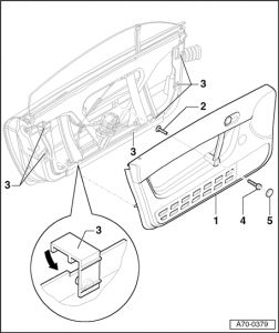

Repair requires disassembly of the inside Driver's door panel to access the latch assembly for replacement. Any comments on how the remove the panel W/O defacing it in search of fasteners?

Front door trim, removing and installing Fig. 105: Front Door Trim Remove/Install Components
https://images.2carpros.com/forum/automotive_pictures/266999_tt_2.jpg
1 - Door trim Remove screw cap - 5 - Removing screw cap Remove screw - 4 - (1x). Unclip inner and outer connecting pieces. Lift door trim about 20 cm upward and remove from door. Detach release cable for interior door handle Detaching release cable Disconnect electrical connectors
