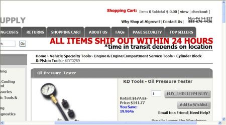

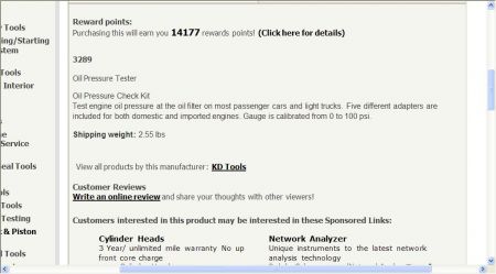

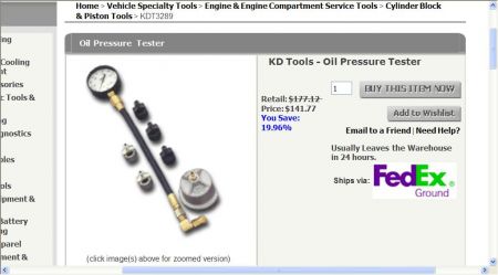

So busy I've overlook you-its called oil pressure tester different names for different people. I call it mechanical gauge- See below
Try going to this website www.kdtools.com if there's such
https://www.2carpros.com/forum/automotive_pictures/12900_1_2.jpg
https://www.2carpros.com/forum/automotive_pictures/12900_oil_pressure_tester_1.jpg
https://www.2carpros.com/forum/automotive_pictures/12900_oil_pressure2_1.jpg
