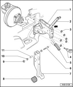

I have checked inside car fuse for brake lights and it appears good. I have checked brake bulb I left side and it looks good but neither brake light works but tail lights all work. What do you recommend?

Hi there, Check that you have power, at & through the brake light switch when pedal is pressed, see item 4 in pic for location. Mark (mhpautos)
