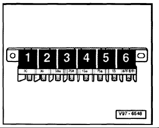

I replaced the transmission on my 1998 audi a8 Quattro, new neutral safety switch, new starter, If I turn on the key and go to the starter and jump it, FIRES RIGHT UP, but from the key...Nothing..the power wire for the solenoid...Nothing...Maybe a Relay?...Help

Hi jeffseybold, Welcome to 2carpros and TY for the donation Check and test the starting interlock relay-see pic below
https://images.2carpros.com/forum/automotive_pictures/12900_s1_43.jpg
https://images.2carpros.com/forum/automotive_pictures/12900_s2_40.jpg

I have opened the floor board, What I have in my Schematics are not even close, I just need to know which one?

Its on no.4 see below
https://images.2carpros.com/forum/automotive_pictures/12900_starter_relay_audi_1.gif

Sir, On my 1998 Audi A8 Quattro, # 4 and # 5 are Vacated?

My references Mit1 and Alldata gives me the same location for the starting relay both for A8 and A8 Quattro
Also there's no neutral safety switch for both-The starting circuit starts at the ignition switch then thru the starting relay and straight to the starter-after the central locking and alarm system/interior light delay module located left side of luggage compartment near wheelwell grounds the starting relay to complete the starting circuit.
