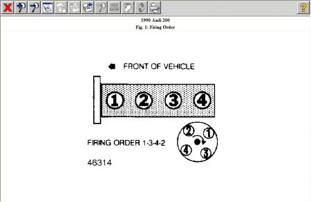

I wanted to save some money an I screwed myself. I need to know the fire order on a bosch distributor cap for my Audi 200 turbo...Any ideas

See below
https://images.2carpros.com/forum/automotive_pictures/12900_f1_2.jpg
