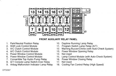

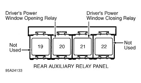

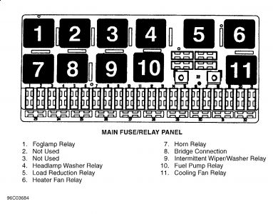

Good morning,
Can I ask you to please send me a block diagram of the main fuse panel and the front fuse panel fo my audi.
I need to know the location positions for relays #18 & #11.
Please, I ask that you send it to me in a format that I can read as I received a schematic the other day and it was so small, I couldn't see it.
Thanks in advance for your help!
Aug 14, 2009 at 2:00 AM
DOCFIXIT
  • 18,828 POSTS
Maybe this will work
https://images.2carpros.com/forum/automotive_pictures/198357_Graphic_60.jpg
https://images.2carpros.com/forum/automotive_pictures/198357_Grafic_3_12.jpg
https://images.2carpros.com/forum/automotive_pictures/198357_Grafic_4_3.jpg
