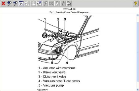

My cruise control rcently quit. Fuse good, do i need to change the entire switch? Old cars, usually just a loose vacumn hose...lol

Hi A8thomas, Depending on the reason it quit. Attached is a component diagram, check for vacumn leaks first.
