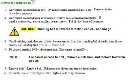

I am here to find out how to remove a bad alternator on a 1999 Audi A8.

Sep 18, 2009 at 2:18 PM
