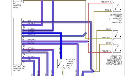

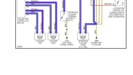

Hi Transporter2, Welcome to 2carpros and TY for the donation You need to get the coolant fan control module checked out-see below
https://images.2carpros.com/forum/automotive_pictures/12900_c1_31.jpg
https://images.2carpros.com/forum/automotive_pictures/12900_c2_29.jpg
https://images.2carpros.com/forum/automotive_pictures/12900_c3_11.jpg

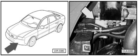

Thank you for your quick response Rasmataz, located the module right udner the left frame rail (driver's side). Will keep you posted once checked.

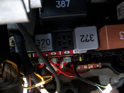

Hi Rasmataz, I replaced the control module to no avail. Supplied the two fans with a separate 12v and they function. Checked all the fuses that I know of (under the driver's steering wheel (attached is what I saw) and by the driver's side door) and they are all good to go. Is there anything else that Iam missing? Maybe on the control module, it's not as easy as taking out the old one, attaching the connectors to the new one (which I did) and all should run well. Thank you for your help. Brgds, Vex.
https://images.2carpros.com/forum/automotive_pictures/530914_fuse_2.jpg

Inspect and test the after run thermal switch this switch has to close to ground the fan motors.

Is this a 2.7 or 2.8 liter engine its gonna get complicated here-there's is 2 of the thermal switch BTW where did you find the coolant fan control module is it here -see pic
https://images.2carpros.com/forum/automotive_pictures/12900_cfcm_1.jpg

Its a 2.8 and from the picture, confirmed that I found it on that exact point i.e. right under the rail frame on the driver's side, right infront of the oil filter. Brgds, Transporter2

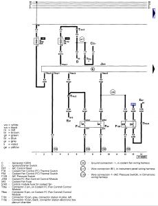

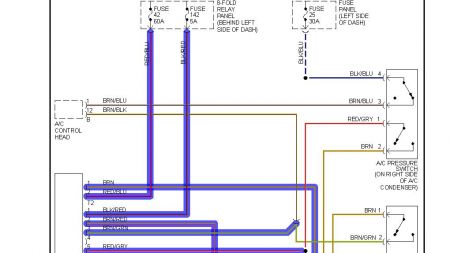

Sir-I don't think I can give the locations of these thermal switches it won't give me thru Mit1 and Alldata but if you follow the correct colors at the coolant fan control module it will take you there-see pic if it comes blurry give me your email addy
https://images.2carpros.com/forum/automotive_pictures/12900_cfcm_2.jpg
