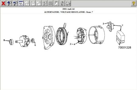

Are you saying that the Volt Regulator is the problem? Cool. That sounds better. Can I do that myself? Where is it in the car? Does anyoen know how to change it?

Hi toddmitchem, It is item # 7 in the diagram. You need to remove the alternator to get at it.
https://images.2carpros.com/forum/automotive_pictures/192750_Alternator01AudiA6_1.jpg
If the voltage is too high, the voltage regulator is the prime suspect.
