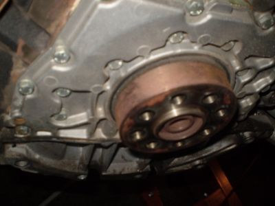

I just have a question for someone who has knowledge on the cranks and flywheels for the 2.7.
The engine went out in my 200 A6 2.7t 6 speed.
I bought a replacement 2.7t engine from a 2001 tipronic 5 Allroad.
My flywheel bolts do not reach the crank!!!
The tip5 flywheel is much thinner, its like its recessed and the starter lines up with it.
Although the 6speed Flywheel is about 1-2" thick and it is not recessed and does not match up with the starter.
I know that people have put the 6 speed in A6's that had tiptronic.
Do i just need the 6speed starter or swap the cranks or different flywheel or what?
Please help ASAP, thank you

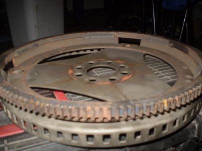

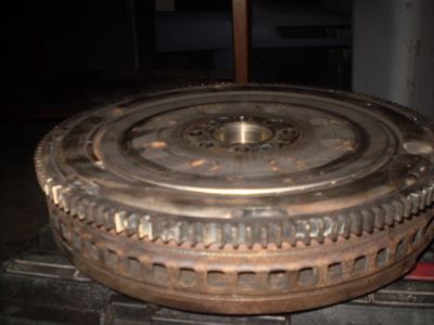

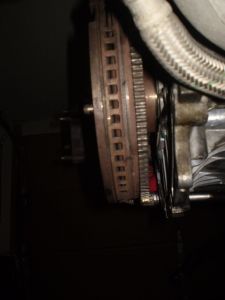

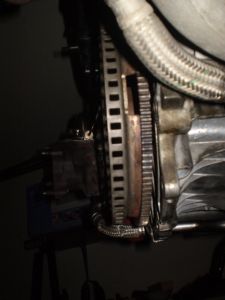

The flex plate from the tiptronic is thin, the flywheel from my standard is to thick. The original flywheel is too thick. The pictures will explain more

I have not done any such replacements before so is not sure if the length of the crankshaft protruding part for both engines are different.
From your description, it seems the crankshaft is different for both engines.
From the picture, the manual flywheel does not seem to be seated fully and is too far out.
Under such circumstances, the crankshaft is the main problem and either it has to be replaced or machined to the correct lenght to be usable.

Well if it is the crank length, is it possible to get the flywheel machined to fit? If that's not possible, i would like to keep the bottom end of the engine together and get that machined?

YEEEAAAA!!!!!! that last picture of the crank is not apart of the crank. It is a spacer about an 1" thick and i hit it with a mallet a couple times and it fell off! Everything bolts up fine now.
Future reference for any one getting an engine from a tiptronic going in a manual. There is a 1" circle block spacer that wieghts about 5lbs you need to pull off, and thats it. That spacer is in between the tiptronic flex plate and the engine block.
