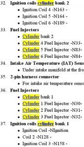

Looking at the front of the car what are the cylinder numbers?
Sep 15, 2007 at 3:58 AM
SERVICE WRITER
  • 9,123 POSTS
I've spent 45 minutes scouring through by technical software trying to help you. This is the best I could find, so you'll have to back your way into it. I'm hoping there are numbers on the fuel injectors that correspond with this chart:
https://images.2carpros.com/forum/automotive_pictures/30961_audi_1.jpg
https://images.2carpros.com/forum/automotive_pictures/30961_mitchel_16.jpg
