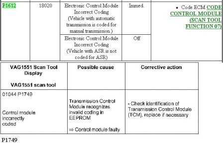

I have the codes p1612 and p1749 come up when I scan my car. So I bought a tranny computer for the car. The problem is that I have to program it now to make it work. I have a fully registered version of vag-com, and woul dlike to know how to program it through that program.

In my opinion, the TCM may fix P1749 but according to the chart you may need an ECM to fix P1612. But you can probably re-program your current ECM, maybe. Anyway, I am sending you via email the instruction for VAG1551 scan tool procedure. It is way too big to post.

I dont have the vag 1551. I have the vag com program installed through my laptop. I have different commands than the 1551 has. Please find a way to do it through my laptop.
