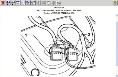

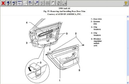

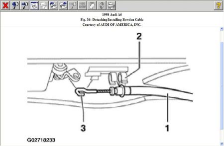

How do you take off the rear door panel in a 1998 audi a6 wagon?

REAR DOOR TRIM, REMOVING AND INSTALLING 1. Door trim  Remove screws -2- (2x) from door trim -1-.  Remove window regulator switch unit -5-.  Lift door trim about 20 cm upward and remove from door.  Detach Bowden cable for interior door handle. See DETACHING BOWDEN CABLE .  Disconnect electrical connectors. See DISCONNECTING ELECTRICAL CONNECTORS . Clip locators -3- (6x) and -4- (1x) must be clipped in place when installing door trim. When installing, press center of door trim onto door. 2. Screws (2x)  Tightening torque: 1.5 Nm (13 in lb) 3. Clip locators 4. Clip locators 5. Window regulator switch unit Detaching Bowden cable  Pull Bowden cable -1- out of guide -2- and detach.
https://images.2carpros.com/forum/automotive_pictures/192750_DoorBowden98AudiA6_1.jpg
Fig. 36: Detaching/Installing Bowden Cable Courtesy of AUDI OF AMERICA, INC. Disconnecting electrical connectors  Disconnect connector for door warning light -2-.  Disconnect connector for loudspeaker -1-.
https://images.2carpros.com/forum/automotive_pictures/192750_DoorBowden98AudiA601_1.jpg
Fig. 37: Disconnecting Electrical Connectors - Rear Door Courtesy of AUDI OF AMERICA, INC. NOTE: When installing, make sure hook -3- is facing upward. Page 1 of 1 INTERIOR TRIM -1998 Audi A6 9/17/2008
