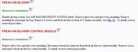

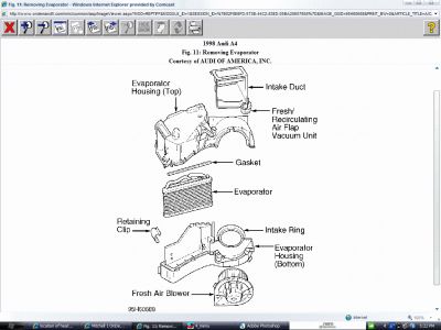

audi a4 2.4se v6 1998 132000 location of fan heater motor in engine compartment is it easy to replace yourself or a garage repair approx price of repair
Nov 18, 2007 at 3:14 PM
MERLIN2021
  • 17,250 POSTS
It doesnt look too bad! Heres how...
