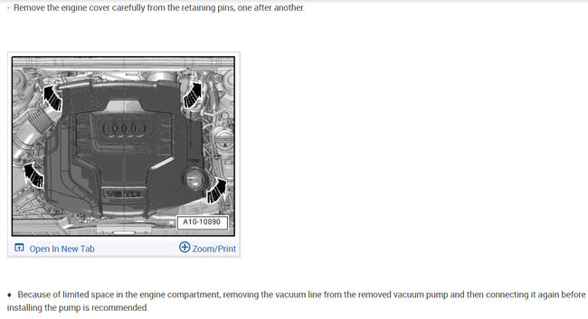

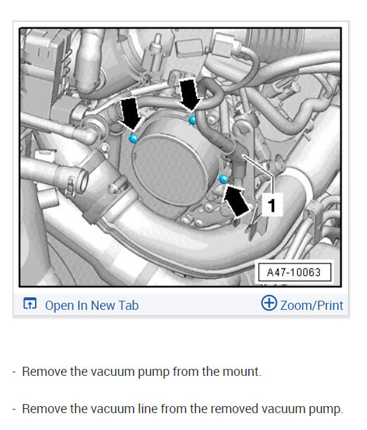

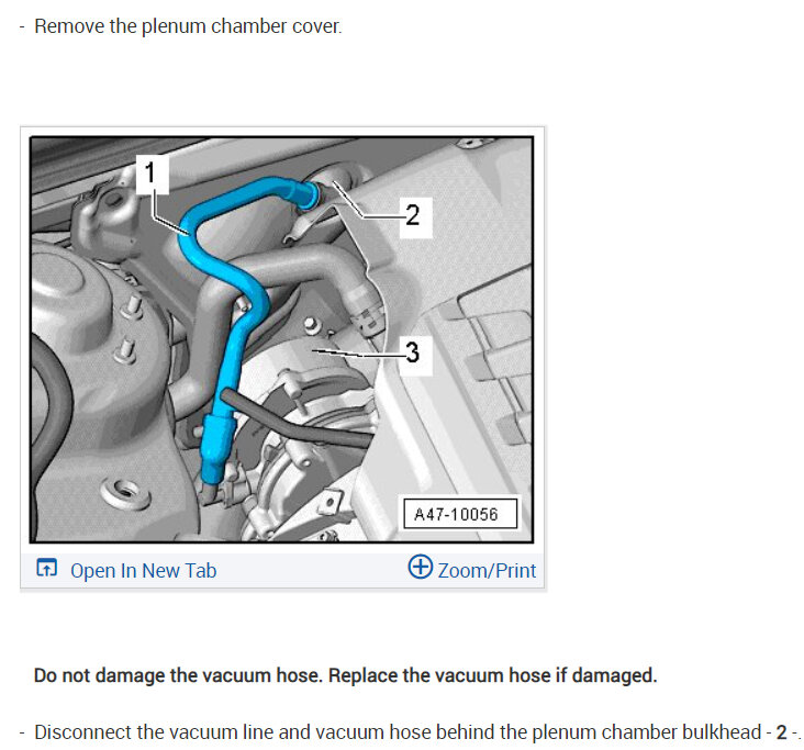

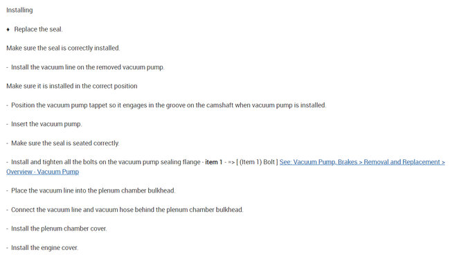

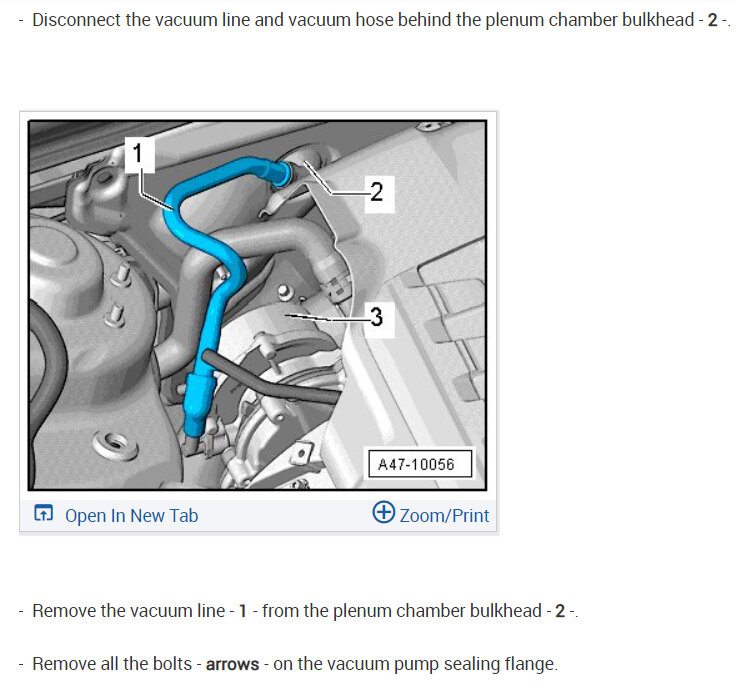

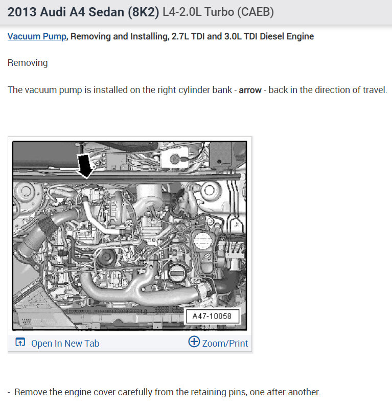

Cold start noise on my vehicle listed above, 2.0-liter TDI, it goes around 4-5 minutes then it disappears. It comes from the back of the engine where the vacuum pump is located. Any solution for this please.
Jan 25, 2024 at 4:46 PM
  • 55,433 POSTS
Yes, it could be the vacuum pump. They have a history of going out on this car. Here are the instructions for changing it out. Check out the images (below). Please let us know what happens.
