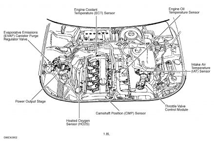

code p1113? banks1 senser1 internal resistance too high.. What do I do?

check wiring to or replace H02s ..... let me know if your car is not 1.8L Heated Oxygen Sensor (HO2S) (1.8L)On right side of engine, on exhaust manifold. See Fig. 1
https://images.2carpros.com/forum/automotive_pictures/266999_o2_2.jpg
