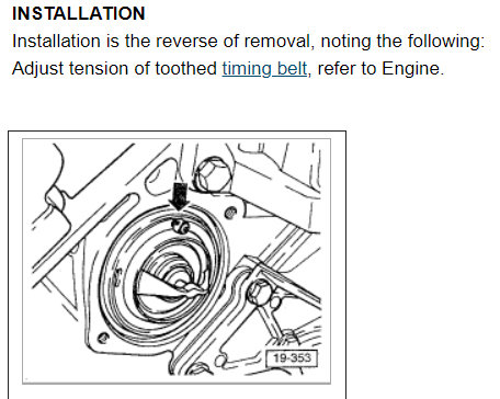

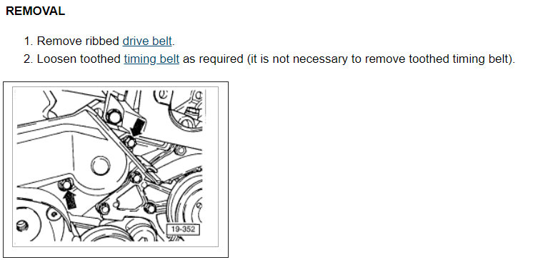

Here is a guide to help you see what you are in for when changing the engine thermostat out.
Here are the diagrams of what it will be like for your car
