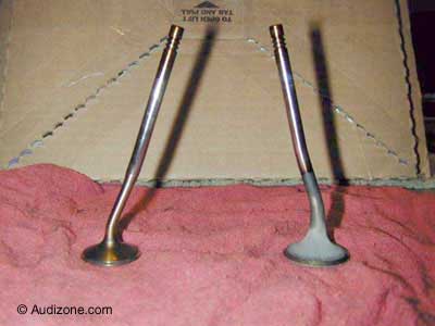

Im looking at getting a 1999 Audi the timing belt went out can that mess up the engine at all?

this will do serious engine damage, i would leave it well alone, see pic for a sample of valve damage from one of these engines.
