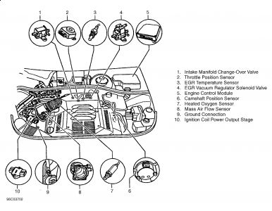

The last post helped a lot, thanks! Now i'm going another route. The TPs Sensor on the a4, is that located within the throttle body? if i needed to replace the TPS, would i have to replace the entire throttle body? I'm prepared to and have done it before but just wondering the locationg of that tps.

Here is a pic of the TPS location and no you do not need to replace the entire thottle body just he sensor.

I have the 1.8T model not the V6, could you show me a pic of the four cylinder version please?

I am sorry that is the only pic that they even give. It is on the intake under the throttle body. So it sounds like you will be taking the throttle body off to get to it. Hope this helps.
