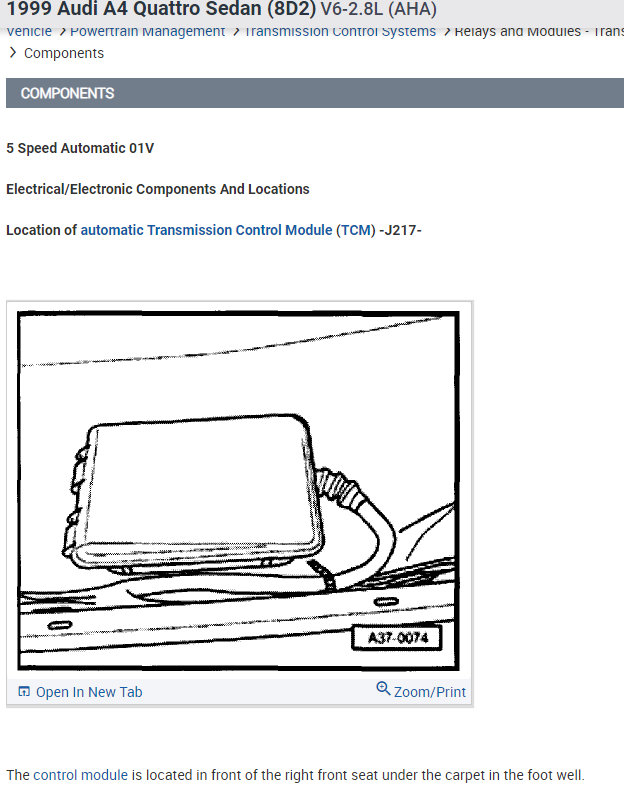

What is a transmission module and where is it located?
Sep 23, 2010 at 12:36 PM
SQM
  • 6,383 POSTS
The transmission control module controls the overall transmission operations. It is basically the brain of the transmission.
The control module is located in front of the right front seat under the carpet in the foot well.
