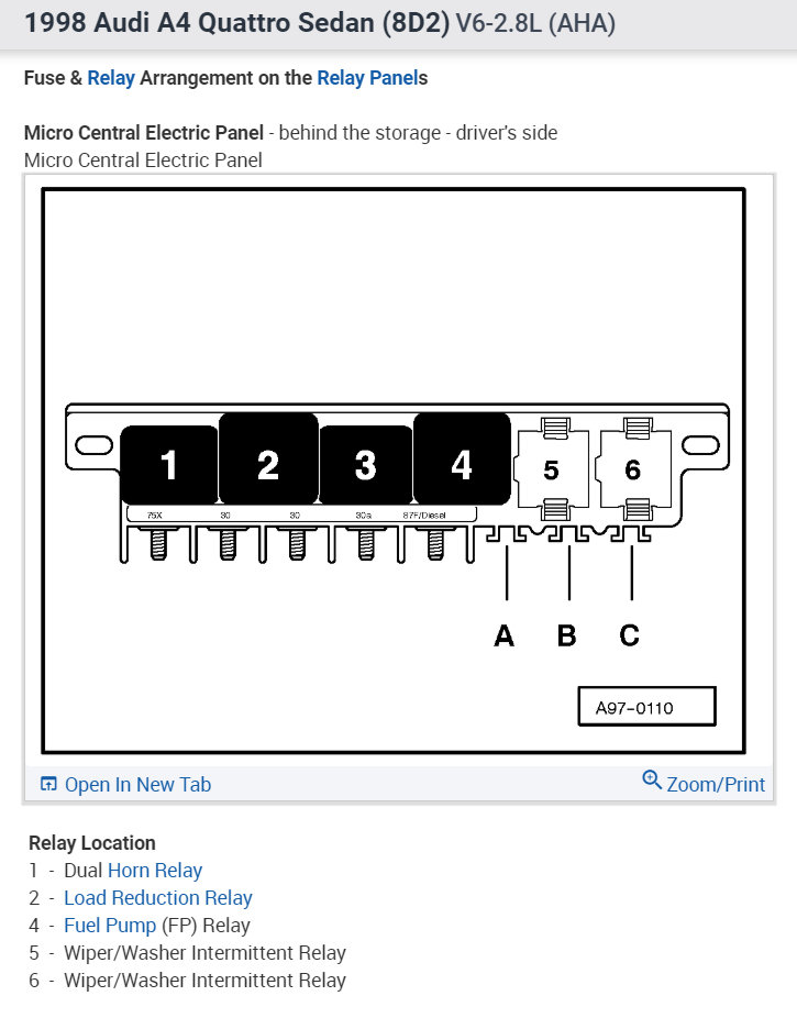

What is the location of the fuel pump relay. I know its located left side under the dash. I just don't know which relay it is. Thank you.
May 27, 2010 at 1:38 PM
DOCFIXIT
  • 18,828 POSTS
Here is a guide to help test the relay and the relay location in the diagrams below.
