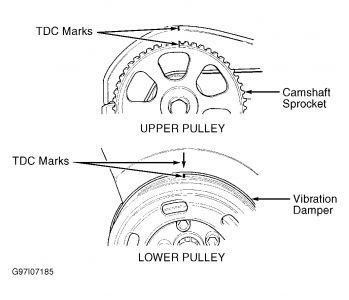

1997 Audi A4 4 cyl All Wheel Drive Manual
I need the timing belt marks for my 97 Audi A4 Quattro. I believe the belt slipped on pulley while disassembling to get to water pump that I am replacing. Where should timing marks be located.

https://images.2carpros.com/forum/automotive_pictures/261618_Graphic_665.jpg
