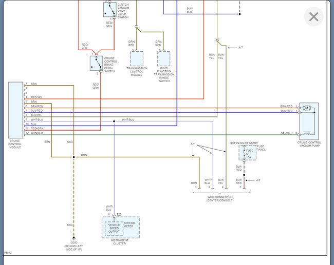

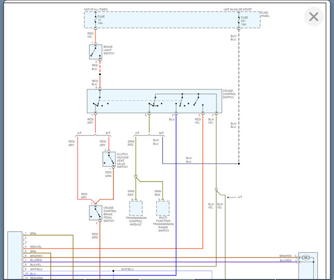

I love my car listed above with a 1.8 turbo. Except for the electrical gremlins. My problem is that my speed control only works when it is really hot outside, and the car has been sitting in the sun for a while. I do not know how to even access it. I think it's on the right-side passenger underneath the glovebox?? but who knows!
Oct 7, 2010 at 1:43 PM
More than likely this is an issue with the cruise control vacuum pump. Within this system this is the only component that would be affected by heat. So, I suspect you have a leak in the line going from the pump to the servo.
So, we should connect the pump to a gauge and then drive the vehicle to find out if the pump is working.

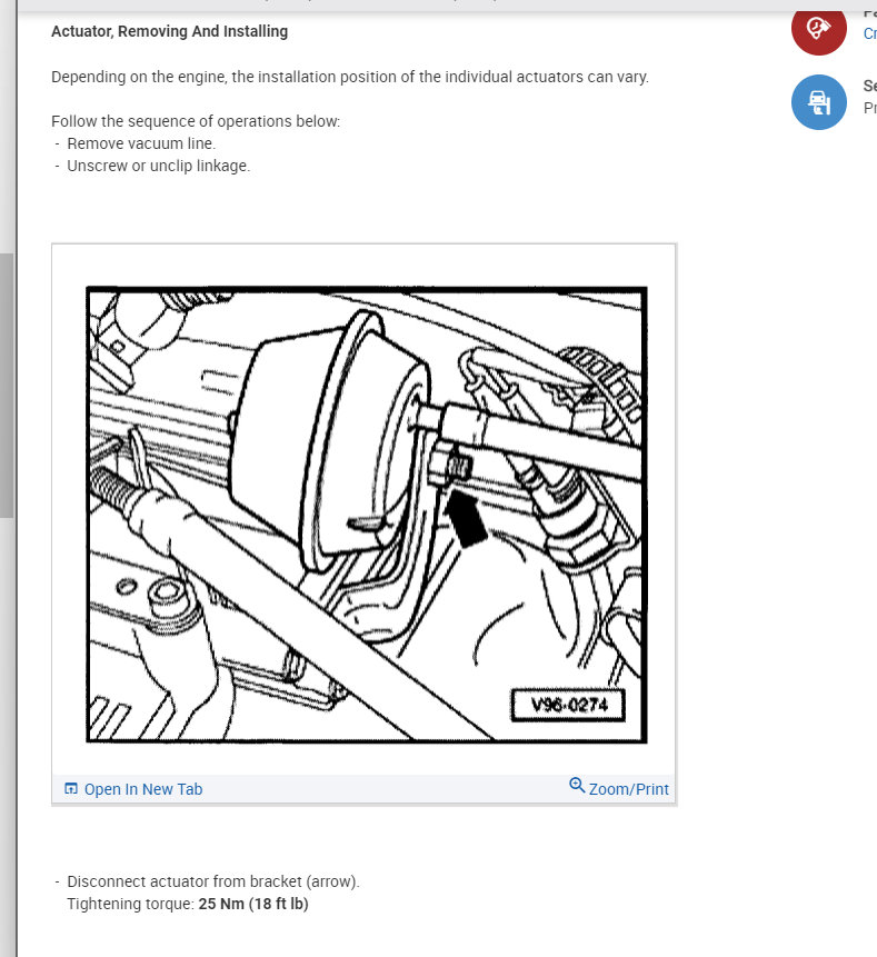

The other likely cause is the servo itself.
I am attaching the info on how to replace this below so let me know what questions you have.
