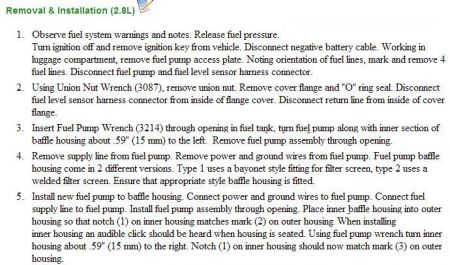

Hello.
Can the fuel pump be changed without draining the tank?
I have the cover off the tank (under the carpet in the trunk), but the pump is mounted at the bottom of the tank.
Is it just a reach in and twist off scenario?
Thanks.

https://images.2carpros.com/forum/automotive_pictures/261618_Noname_974.jpg
https://images.2carpros.com/forum/automotive_pictures/261618_Noname2_271.jpg
