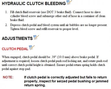

i will like to know how to bleed the clutch.the clutch padal don't work at all.and where to bleed or ajust it'for i can used the gears;

https://images.2carpros.com/forum/automotive_pictures/261618_Noname_2227.jpg
