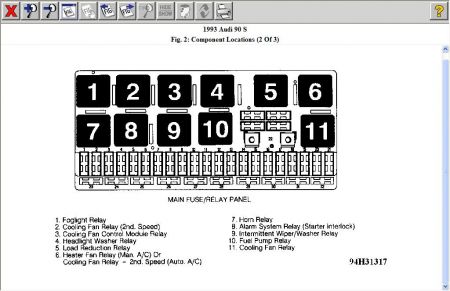

Ok - this may sound stupid but when I opened the relay box, it appears to be missing some of the relays - and specifically some of those relating to the cooling fan. I don't think anyone removed them recently either. Is it normal to have open spots? And when you say switch sides - can you be more specific? Thanks much.
Saturday, November 1st, 2008 AT 2:07 PM
  • 75,992 POSTS
Switch sides-means the switch side of the relay
https://www.2carpros.com/forum/automotive_pictures/12900_fan_relay_4.jpg
Saturday, November 1st, 2008 AT 2:20 PM
LATCHKEY
  • 7 POSTS
Ok - so Ive located that panel. How would I know if the switch is stuck? #2 and #11 are empty. Or am I looking for another one on or near the radiator? I am a bit of a novice as you can see. :-)
Sunday, November 2nd, 2008 AT 8:19 PM
  • 75,992 POSTS
Remove the no.3 and 6 and see what happens
Sunday, November 2nd, 2008 AT 9:28 PM
LATCHKEY
  • 7 POSTS
So I pulled each one of them when the car was being jumped and kept coming back and forth testing different combinations, but the fan continued even when both the 3 and 6 were pulled - together and separate. I would have expected the fan to stop altogether at some point - with the switch removed yes?

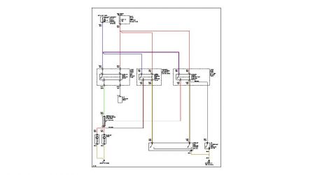

Do you happen to have the wiring diagram for this model that I could see on this site? Also, is it possible that the run on fan switch needs replacing? Is there a way to test that?
Thursday, November 6th, 2008 AT 9:53 AM
  • 75,992 POSTS
https://www.2carpros.com/forum/automotive_pictures/12900_1993_Audi_90_cooling_fan_1.jpg
Thursday, November 6th, 2008 AT 11:14 AM
LATCHKEY
  • 7 POSTS
So I fixed the problem - was actually a different relay than the originial one suspected. It was the run-on fan switch relay which was stuck. This relay is found in the relay box under the driver side dash.
