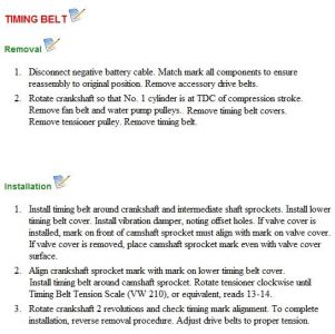

1992 Audi 100 water pump
1992 AUDI 100
184,000 MILES • 6 CYL • FWD • AUTOMATIC
TREV123CLEV
Replace Water pump Details
May 2, 2010 at 5:39 PM
BLUELIGHTNIN6
  • 16,542 POSTS
timing belt is biggest part of replacing the water pump. timing belt replacement steps are below, once belt is off just remove water pump bolts.
